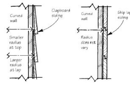

Q: I am trying to put 1/2x4-inch redwood beveled siding on a wall with a 4-ft. 8-in. radius. It doesn’t seem like a very tight radius, but so far I have only gotten up three courses before a board splits out. It seems as if each piece wants to pull further from the wall at the top. I have some pieces soaking in a tub of water hoping that will make it more pliable. Do you have any suggestions? Read more
