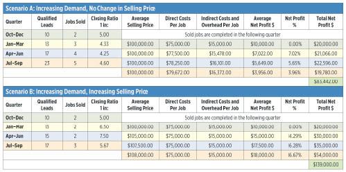

These spreadsheet scenarios illustrate two different responses a remodeling company could make to an increasing demand for its services (as tracked in the Qualified Leads column). In Scenario A, the owner chooses to take on more jobs than the two per quarter he had budgeted - but at the same average selling price and using the same crew. As a result, the pace of work becomes more hectic and costs rise as, for example, the company has to hire out work that it previously kept in-house in order to meet the schedule. Even a modest rise in direct and indirect costs has a noticeable effect on profit percentage. In Scenario B, the owner decides instead to raise the selling price, then selects the best clients from among a more slowly increasing pool of leads. By focusing on efficiency and organization, the company is able to produce an additional job in the fourth quarter, and profits for the year increase substantially.
