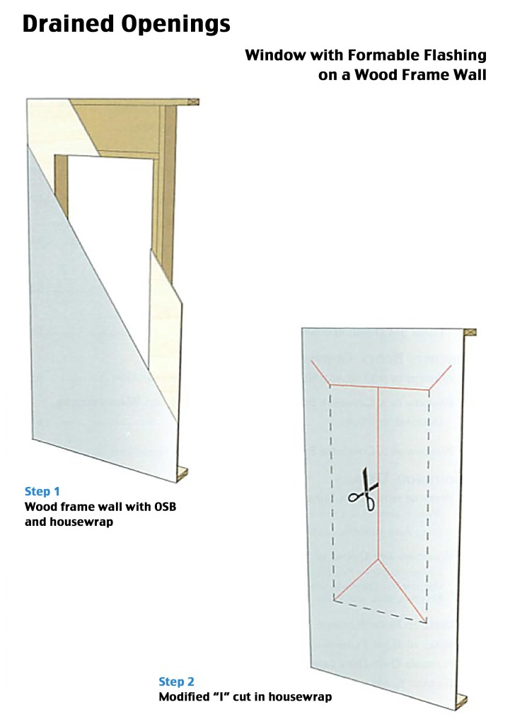

Previously, for drained openings installers simply cut an X in the wrap over the opening. ASTM E2112 now calls for cutting a tab at the top to create a through-wall flashing at the window head.

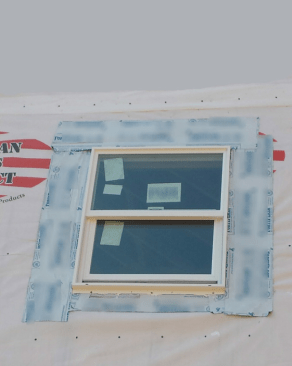

2. Using the wrong kind of self-adhering flashing tape around windows. Properly installed windows should follow ASTM E2112, which offers a guide for how to wrap window openings and install flashing (see illustration).
Using drainable wraps in combination with flashing adds even more insurance against water damage from this common failure point.
But because drainable wraps have a drainage plain that’s about 1.5 mm, they require a thicker self-adhering flashing tape. Choose a tape that is at least 20 to 25 mils thick to ensure the drainage plain is properly sealed.
This window shows what not to do when using any kind of housewrap around a window. It is an example of the old system of cutting an “X” and folding in the wrap. Notice the self-adhered flashing tape is not shingle-lapped at the head and isn’t cut to the right lengths.
