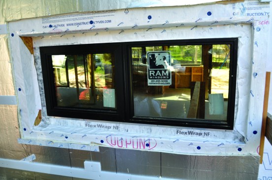

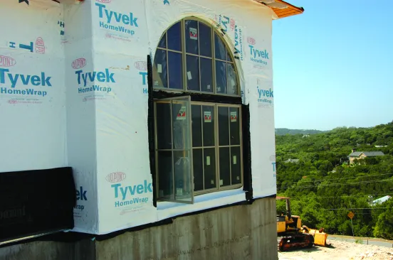

Driving by this site, the author stopped to look at the detailing on a large, recessed arch-top window. From  a distance, it was evident it wasn’t flashed well.
How Not to Do a Recessed Window

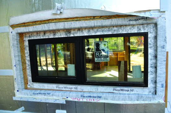

We see a lot of recessed windows in my area in Austin, Texas, particularly on Tuscan-style or Spanish Colonial homes where the windows are recessed to give the impression of an extra-thick masonry or adobe wall. Nearly all these homes are wood-framed and have stucco exteriors that wrap back into the window well.
The opening had been flashed with a peel-and-stick material, the window unit installed, and then the housewrap simply folded over the returns
Recently, on one of his own sites, he showed up to find his framing sub had done something similar.
Recessed windows are basically a set of two window openings—a larger opening that returns into the wall to a second, recessed face, in which you have the window rough opening. The way builders typically detail this stepped opening is shown in the photos. First, they install a peel-and-stick membrane (or worse, a laminated-plastic-and-paper flashing, which doesn’t hold up well to UV light and usually begins to deteriorate before the job is completed). The jamb flashing is folded around all the corners and crevices in the recessed window well. Then, whatever WRB is used on the walls is folded back into the window well after the window unit has been installed.
Often the window is left like this for the stucco crew to pin down the flaps with lath. Sometimes it’s taped off with sheathing tape, or occasionally another layer of peel-and-stick is applied to cover the window flanges and lap out onto the face of the sheathing. But no matter how many layers are piled on, there are going to be myriad gaps—and probably reverse laps as well.

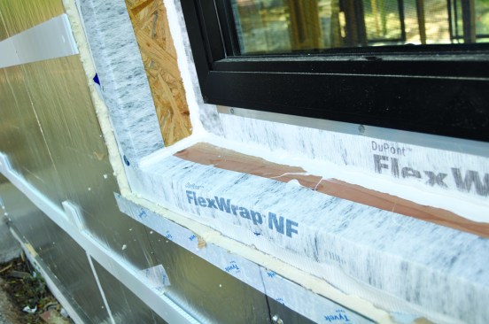

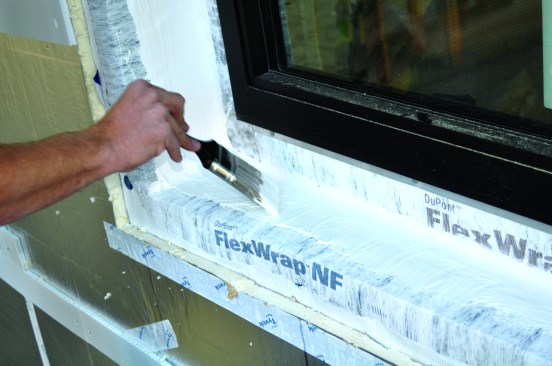

To remedy the botched window job on his site, the author worked with the local Tyvek distributor. The housewrap was peeled back and FlexWrap applied along the edges of the recessed opening and over the window flanges.
Next, Tyvek Flashing and Joint Compound is gun-applied into the corners.
This is followed by a second, more fluid product - Tyvek Brush Formulation.

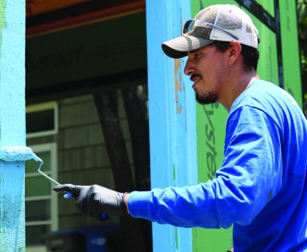

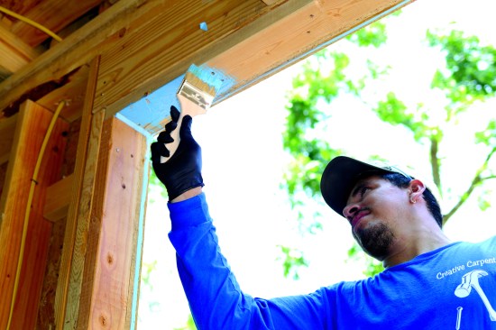

The first time I used a fluid-applied water barrier, I was building a house for which the architect had specified deep window recesses. In the past, I’d used DuPont FlexWrap for these tricky waterproofing details. DuPont has good instructions, but even for the most astute installer, the origami can be confusing. So, I asked my local DuPont rep to meet me on the jobsite to show us how its fluid-applied flashing materials worked for a recessed window.

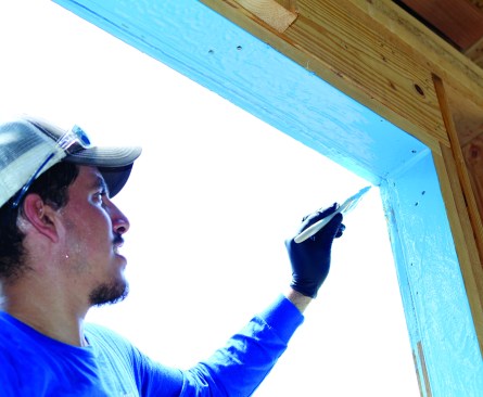

Using the Polyguard Blue Barrier system on one window, a carpenter first applied the thicker of two flashing compounds—Joint Filler 2200—into the corners and to fill the gap between the exterior sheathing and the framing. He then brushed on the thinner, Flash ’N Wrap 2400.
The goal is to create a seamless membrane that covers the entire jamb, all
surfaces of the recessed opening ...
The goal is to create a seamless membrane that covers the entire jamb, all surfaces of the recessed opening ...
... and the face of the surrounding exterior sheathing.
DuPont makes three viscosities. The thinnest (runniest) is a fluid-applied weather barrier that is meant to be sprayed on the bulk of the building’s field. We haven’t used this product, only the two fluid-applied flashing formulations—the thicker, higher-viscosity Flashing and Joint Compound and the thinner Brush Formulation, which feels like a slightly thinned latex caulk. Neither of these liquid materials will stick to any Tyvek building wrap, so all the transitions from the wrap need to have either FlexWrap or StraightFlash as a bridge. We used FlexWrap for the outermost portion of the window as usual, then gunned a heavy bead of the joint compound into the corners. We followed this by applying Brush Formulation, which comes in a quart tube, squeezing out a zig-zag bead and painting it out on the jambs, head, and sill. I was amazed at how easy these products made what is otherwise a very difficult detail—no more folding flexible flashings into corners and hoping the installers got the overlaps correct.

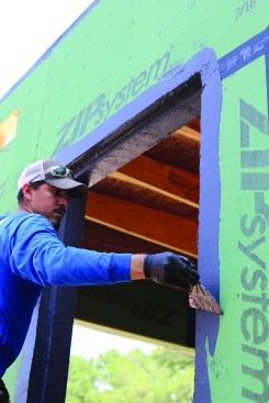

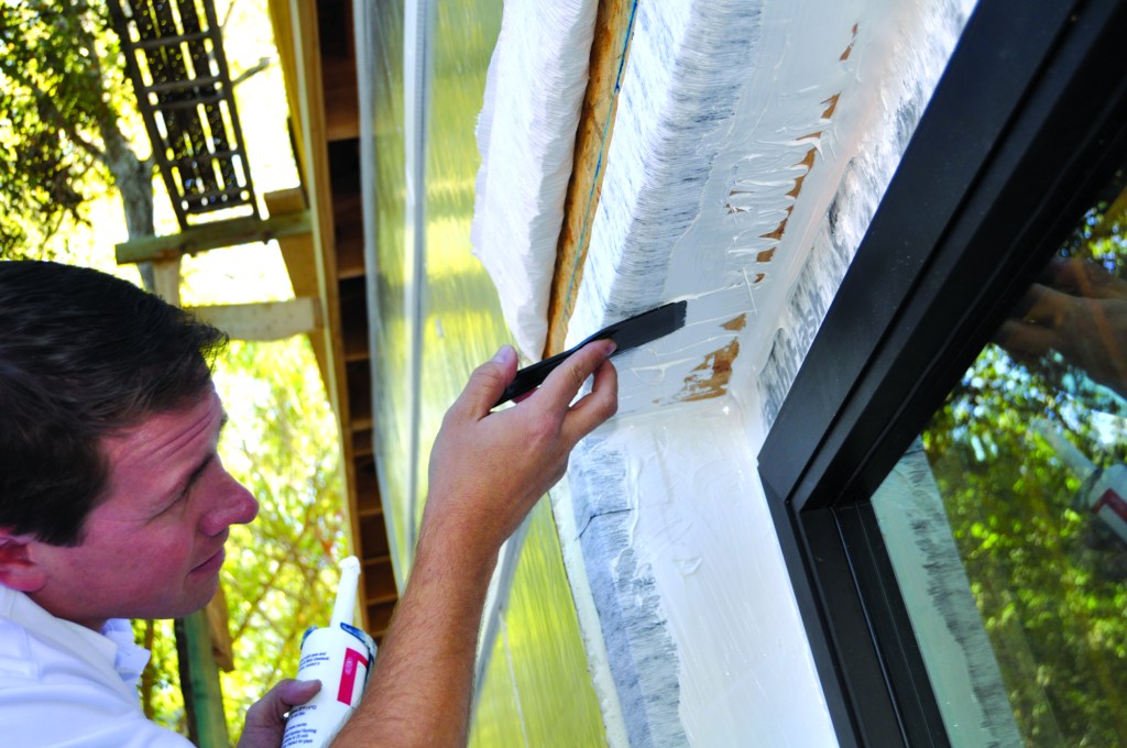

On a second recessed window, a carpenter demonstrates the use of Zip System Liquid Flash. For this product, Huber went with a trowel-grade, single-component material that has a viscosity somewhere between a joint filler and a brush formulation. Step one is to apply a thick bead of Liquid Flash in all the corners and seams, then apply multiple beads on the flat surfaces of the jambs and the step created for the recessed opening, and on the face of the sheathing.
These beads are then smoothed out with a trowel.

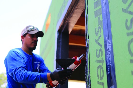

Recently, I drove by a house under construction, and as I always do, I slowed down to scope it out. On that project, the builder was using the Zip System for his sheathing and weather barrier. And like so many houses around here in Austin, it had recessed windows, but it was a fairly modern design and had almost no roof overhang.
I work only on architect-designed homes and have done my share of modern homes with no overhangs. A deep, 2-foot roof overhang will do a good job at shielding (and shading) windows, and I think deep overhangs make the most sense in our climate. But when you build for architects, you have to respect their design decisions, which are often driven by a wide range of factors that appeal to the owner, and climate is almost never one of these. Our job as builders is to just make the design work.
I could see right away on this build that the windows were not being done very well. The builder was using a paper-and-plastic-laminated flashing that is not very sturdy to begin with, and that disintegrates rapidly when exposed to UV light. I see it used all over the South. On this job, as is common practice on windows, it was just stapled to the jambs before the window units were installed. My guess is that the builder was just going with what he’d always seen done; I doubt he was trying to be cheap. In our area, the weather barrier and the window flashing are usually done by the framing crew, and unless you work with your subs on specific detailing practices, they are, understandably, going to do what is most commonly done.
Unsure of what to do on a Zip System wall, a builder simply installed wide pieces of a paper-and-plastic-laminated flashing tape, which he planned to secure with Zip System sheathing tape. This detail would likely have deteriorated quickly and become a homeowner’s nightmare. With almost no roof overhang on this house, these openings will be exposed to a deluge of water.
I decided to approach the builder as humbly as I could to introduce myself and tell him what I have learned about flashing recessed windows. Surprisingly, he was very receptive to hearing me out and seemed to appreciate the insights I had to offer. Because I was working on this article, and wanted to use the example in my video blog, I offered to bring my own framing crew over to demonstrate two different products I had samples of—Polyguard Blue Barrier system and Huber Zip System Liquid Flash. As long as the builder would let me film and photograph the demonstration, I didn’t mind paying my sub a little extra for the job. The photos above how we applied the two different flashing systems. For more, see the video linked below. After the windows are installed, the flanges will be coated with more Liquid Flash.
