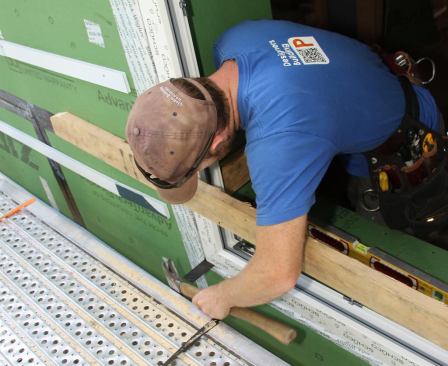

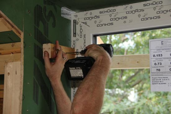

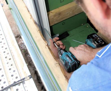

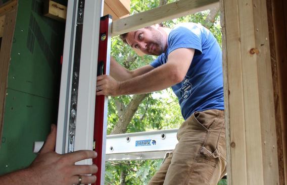

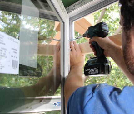

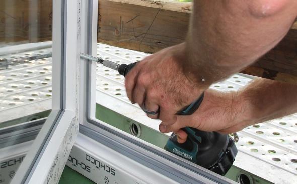

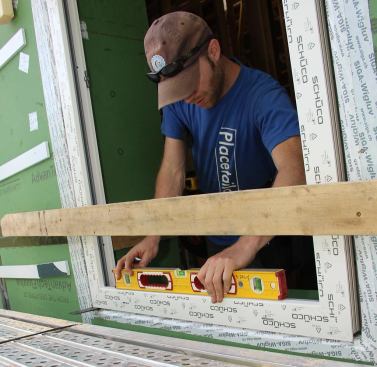

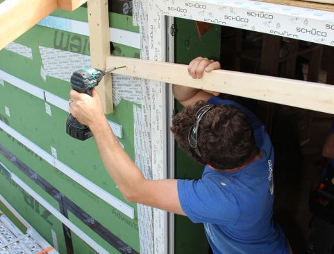

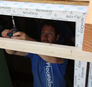

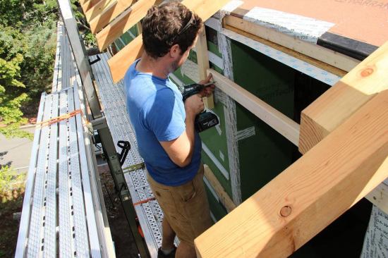

The design calls for the windows to sit flush to the outside sheathing of the drainable wall assembly. A system of bolts through the jamb makes setting the tilt-and-turn windows a simple operation: The crew screws temporary rails across the opening to keep the window from falling out; sets the window in place; screws temporary blocks to the inside buck jambs to hold the window steady; then opens the window to plumb and level the unit and set the supplied self-tapping lag bolts (see slideshow).

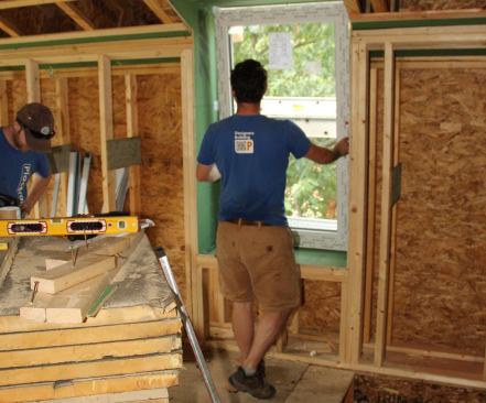

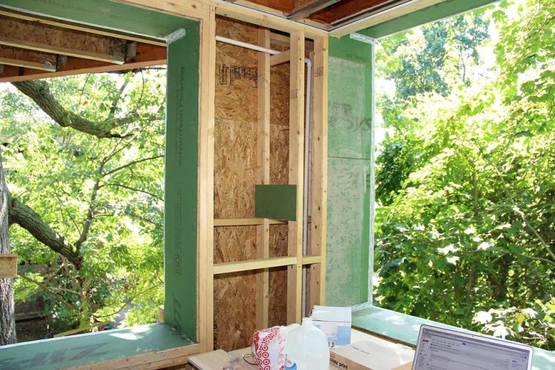

A set of framed window openings in the northwest corner of the two-family in-fill building in Roxbury, Massachusetts. Walls are 16-inch–deep, double-stud construction, with inner and outer walls joined with plywood gussets. Exterior sheathing and window bucks are ZIP System structural panels.

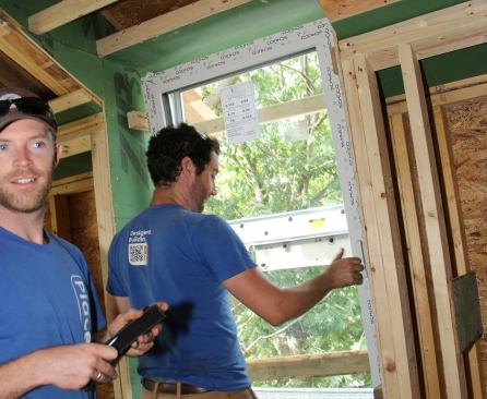

Window labels call out the different solar gain characteristics and heat emission values for the window glazings used for different wall orientations and solar exposures. Higher solar gain windows are placed on the south side, while the east and west windows are chosen for reduced heat loss.

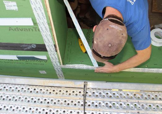

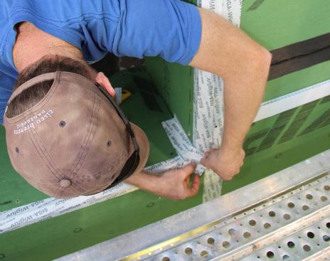

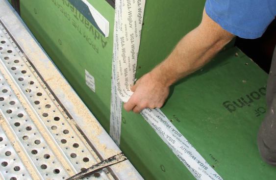

A crew member tapes the exterior window edge to the wall sheathing after the window is placed.

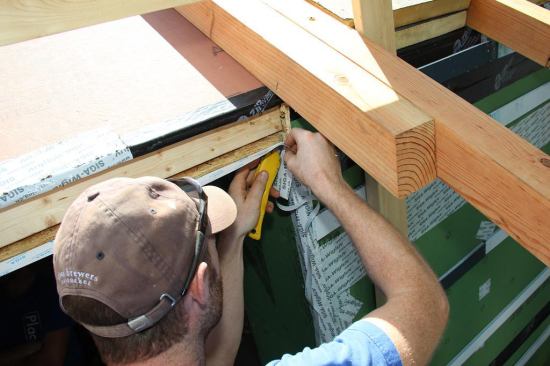

The bolted connection also makes sealing the windows into the wall relatively simple: The crew tapes the outside edge of the window to the wall sheathing, fills the gap between the window and the framing bucks with expanding foam insulation sealant, trims the sealant flush on the inside and tapes the inside edge to the window buck.
