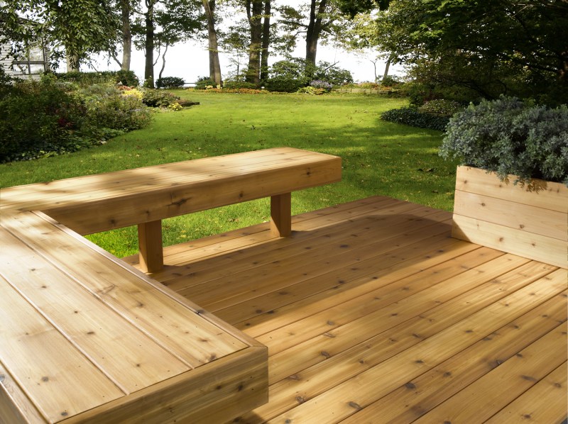

Follow these guidelines to prepare for applying stains. Make sure the surface is clean (no dust, dirt, wood fibers or grease), dry, and free from mildew. When a surface is not clean, stains and other finishes have trouble sticking and may end up peeling.
  • Thoroughly sweep the deck to remove debris.
  • Liberally apply cleaner using a roller or pump sprayer (wear protective equipment to avoid contact with skin and eyes).
  • Allow the cleaner to set for 15 minutes. Mist your work area with a garden hose to keep it wet while the cleaner soaks into the wood.
  • If you encounter grease stains, clean with a TSP substitute or another mild detergent.
  • After 15 minutes, work the cleaner into the surface using a stiff synthetic-bristle brush. Scrub to remove residue thoroughly.
  • Use a garden hose to completely rinse the cleaner from the wood.
  • Once the deck is completely dry, lightly sand any areas of new wood to remove any remaining residue.
Get the highest quality results from your deck project by following these guidelines.
  1. Ensure your deck has been cleaned properly. Before applying stain, sprinkle some water on the deck. If the droplets sink in, the wood is ready to be stained.
  2. Working with the wood grain, apply an even coat of stain using a 4-inch brush. You may also use a roller to first apply the stain, then work into the wood with your brush.
  3. Always read the product data guide. For best results, avoid staining at midday or in direct sunlight.
  4. Depending on temperature and humidity, allow 24 - 48 hours of dry time before using your beautifully stained deck.
