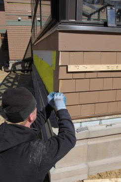

Many installers—either from a design standpoint or because they don’t want to take the extra time—simply butt siding shingles into corner boards. But I vastly prefer the classic look of woven corners, with the shingle siding wrapping seamlessly around the corners of the house.
Additionally, I think woven corners can make the corner of a house more weather­tight than corner boards. You end up with multiple layers of shingles that have alternating seams and that, if installed correctly, can do a better job of keeping water out than a single butt joint between corner boards could.
We recently completed the siding shown in this article on a home for which the owners opted for chocolate-brown prestained white-cedar shingles. The project was a greenhouse addition to the home, and the short section of siding below the greenhouse glazing gives us a good opportunity to look at starting and finishing a corner in just a few courses.

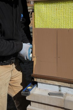

Before I start shingling, I check that the corners of the house are level with respect to each other and with respect to the rest of the house. I also check the spacing of the courses to make sure that the exposure will be consistent top to bottom. In this case, the bottom shingles started over the water-table flashing below, and the top shingles tucked under the trim below the greenhouse glazing above.
A corner weave works by overlapping the edges of successive shingle courses to make the corner weathertight. The trick is to keep the overlap seam in each course even and tight and to alternate the direction of the overlap from course to course.
Shave the edge of the shingle down to the line that you just drew and nail that shingle to the wall

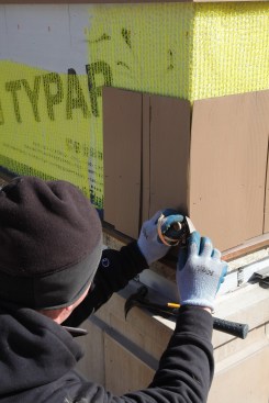

The bottom course on every sidewall shingling project is a double course. The starter course is installed first and is then covered by a second, visible course. The starter course kicks the bottom course away from the wall at the proper angle, and also helps to make the first course weathertight.
I usually shingle a building one wall at a time, wrapping the shingles around the corner to guide the courses on the adjacent wall. I run the starter-course shingles over to about 6 inches from the next corner that I will be weaving. Then, leaving about the same distance from the corner, I install the first few shingles of the starter course on the adjacent wall.

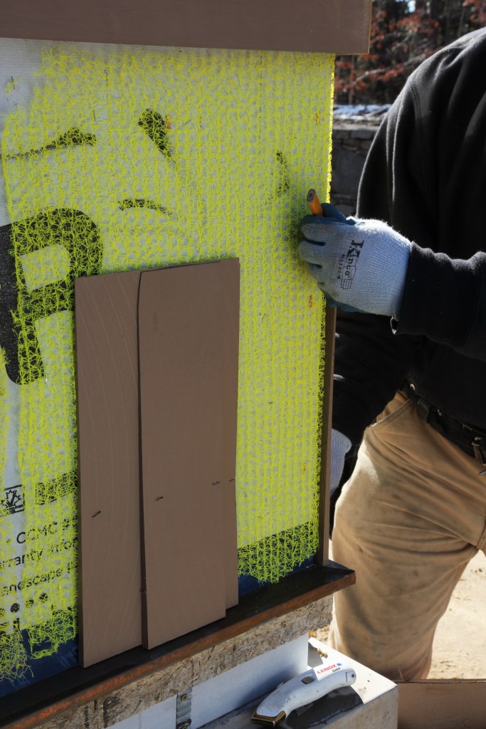

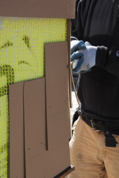

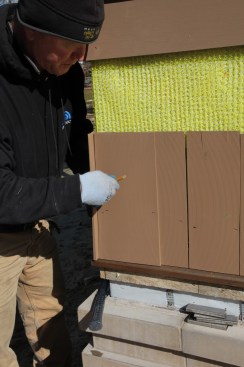

The first corner shingle I pick extends past the corner by an inch or so. Holding the shingle in place, I scribe a line on its back along the end of the wall, leaving plenty of room for the rainscreen. Then I plane the edge of the shingle to my line, and staple it to the wall.
For the corner shingle on the adjacent wall, hold the shingle in place and scribe along the edge of the first shingle. Trim it to fit as before and then nail it into place.
The edge of that first shingle must be trimmed precisely to allow the adjacent shingle to lie flat. If the edge sticks out too much, the adjacent shingle will crack when you fasten it, or the corner will bulge out and the corner seam will open up. And if the edge is shy, there will be a gap and the corner won’t be weathertight. So I fine-tune the edge using a block plane, and then, letting my pencil follow the planed edge, I scribe the starter shingle for the adjacent wall. I then plane it and fasten it into place.

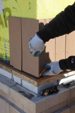

For the outer layer on the bottom course, hold the shingle in place making sure that the clearance at the bottom of the shingle is even with the shingles on the starter course.
Second Layer of Bottom Course
I hold the first corner shingle for the second layer of the bottom course so that the bottom of the shingle is even with the bottom of the starter course, about 1/4 inch above the flashing (4). As recommended by Maibec (and as required by the International Residential Code), I offset the shingle edge at least 1 1/2 inches from the nearest gap between shingles in the previous course—in this case, the starter course—and I make sure my corner shingles are always a minimum of 3 inches wide.
The first corner shingle for the outer layer is scribed and attached. The edge is smoothed with a block plane kept flat against adjacent shingle.

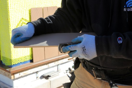

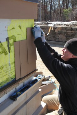

Using a sharp pencil, I draw a line on the back of the shingle, following the edge of the corner. If there’s only a small amount of material to remove, I shave to the line using a block plane, and when the edge of the shingle is nearly perfect, I nail it in place. I do any fine-tuning by making a couple of passes with a block plane, keeping the sole of the plane absolutely flat against the adjacent shingle.
When there is too much waste material to plane off, first draw the scribe line at the corner along the edge of the adjacent shingle.

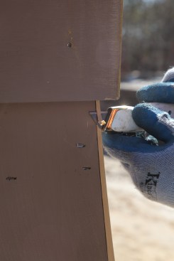

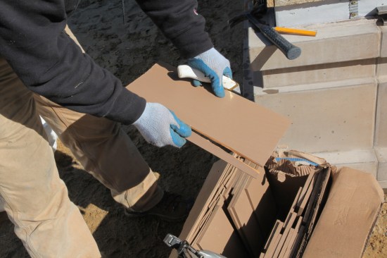

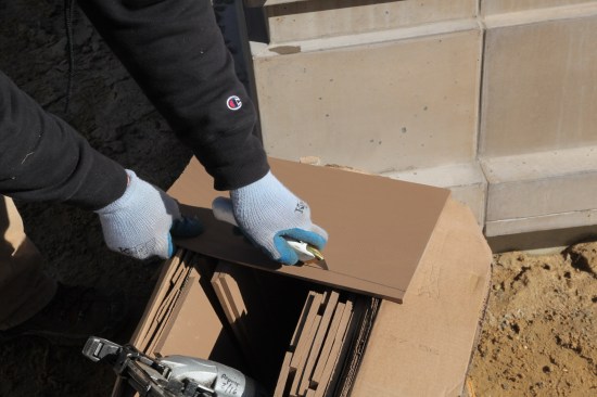

Sometimes, though, there’s too much material to efficiently remove it with a plane, so I first score near my scribe line using a razor knife and snap off the waste. Then I plane the edge to the line, fasten the shingle in place, and use a block plane to fine-tune the edge until it’s even with the adjacent shingle.
Next run the blade of a razor knife down the line with the blade just deep enough to score the shingle.

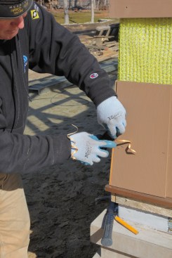

Then just grab the waste and snap it off.

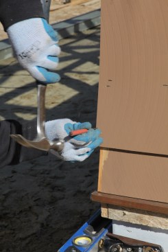

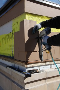

Fastening the Corner

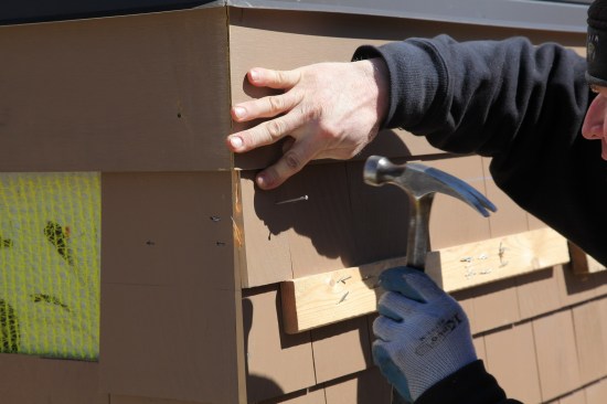

I always use stainless steel fasteners—in this case, 16-gauge staples 1 1/4 inches long with a 7/16-inch crown—to attach sidewall shingles. I fasten each sidewall shingle with two fasteners 1 inch up from the top of the exposure line and about 3/4 inch in from each edge. Fasteners should be driven flush, not overdriven.
For corner shingles, I add a third fastener—a little closer to the corner edge and a little lower than the fastener on that side of the shingle. This helps to stabilize the shingle and anchors the free edge at the corner.
When you're happy with the edge, drive a trim-head stainless steel nail to secure the corner joint. Note that the author adds a second staple on the edge near the corner. This fastener helps to stabilize the corner edges to keep the corner seam from opening up.
I finish the corner on each course by hand-nailing a 6d stainless steel ring-shank trim nail through the face of one shingle and into the edge of the abutting shingle about 2 inches up from the bottom edge. I finish by setting the nail flush.

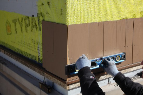

Weaving Successive Courses
After nailing in all the bottom-course shingles along the wall, I measure up for the exposure I need and draw a level line around the corner. It’s imperative that the shingles on the corners be installed dead-on level.
After measuring up for the proper exposure, draw a level line on both sides of the corner to guide the next course.

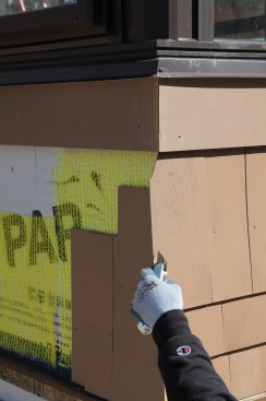

Given the water-table trim on this project, I trimmed the bottom-course shingles before fastening them because I couldn’t plane to the bottoms of the shingles after they were installed. But in most cases, I fasten the shingles first and then trim them flush, which is what I did with the successive courses.
For shingle courses where the entire edge is accessible with plane, Install the shingle first, then gradually cut back the edge with a knife becore finishing it with a block plane.

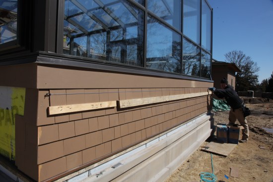

The final course must be face-nailed . Some contractors try to get away with a finish nailer for this step, but I prefer the control and the clean, finished look of hand-nailing with trim-head nails—which are also much better at holding the shingles than finish nails. I snap a line across the course in non-permanent chalk to keep the face nails in a neat, straight line. The corner for the top course is then fastened and trimmed the same way.
The top course has to be face nailed, so the author first slips the shingles behind the molding above and letting them rest on the ledger. Then to make sure the face nails are in a neat straight line, the author snaps a chalk line across the course from end to end.

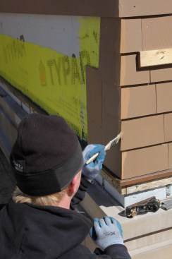

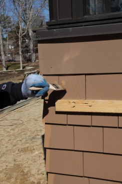

When the entire corner is finished, I check all the edges and smooth out any minor irregularities with a block plane. At this point, I’m shaving off tiny slivers.
A block plane shaves off tiny slivers to fine tune the edge before applying the stain.
To get an exact color match, the bare wood is covered with stain provided by the shingle manufacturer.
Small dabs of stain hide the heads of the face nails as well.
When I’m happy with all the edges, I apply a healthy coat of matching solid-color stain to any bare wood. I make sure to get the exact stain from the shingle manufacturer so that the corners blend in seamlessly with the rest of the shingles when the stain dries. I also dab a little stain on the heads of all the exposed nails, making them all but disappear.
