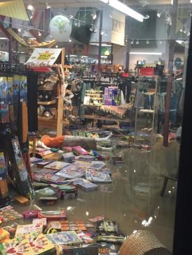

We have had unprecedented rains in Texas this spring, and the resulting flooding has been horrible.  I did a story on my Time Warner News Austin show "Your Home" on this topic, and we filmed at the epicenter of the Austin flooding from last week.  The pictures to follow are all from Whole Earth Provision Co on Lamar Blvd in downtown Austin.  This is a locally owned business and I know the owners, who are terrific people.  Please support their other stores as they endeavor to get this store cleaned up!

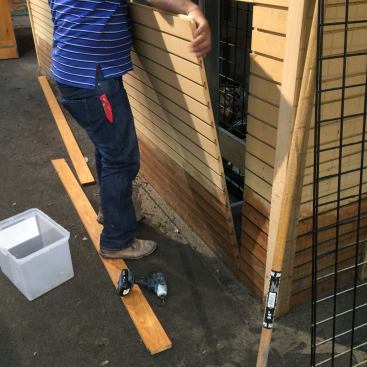

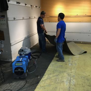

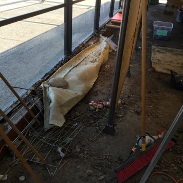

Demo

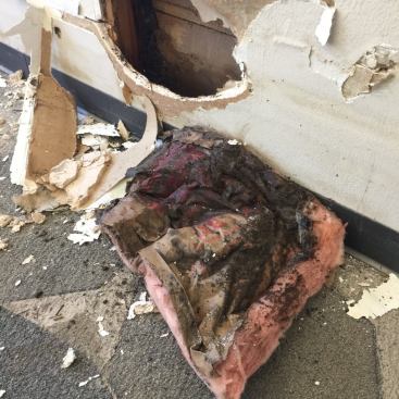

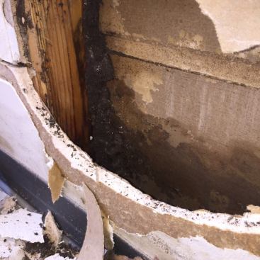

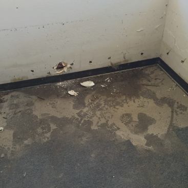

Once the waters recede, the first step in the cleanup is demolition.  Building materials like drywall, insulation, and carpet pads all need to get pitched.  These are absorbent materials that are generally "low cost" and need to be torn out.  Look for the flood line on the walls and demo everything from 1 foot above that line to the floor.  Studs and structure will have soaked up water too, but these can be dried without losing structural integrity.  Do the demo as quickly as possible, as mold and mildew start to be active about 72 hours after flooding.  Wiring can usually be saved, but bring in a licensed electrician to verify.  Plumbing pipes are OK too.  If HVAC duct work has been flooded, it most likely needs to be removed.  Demo back to dry and hard surfaces to get ready for step #2.

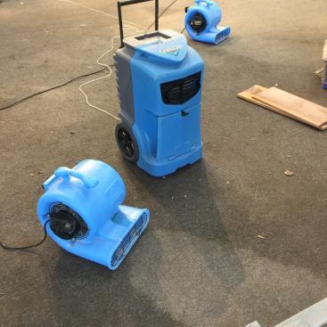

Dry

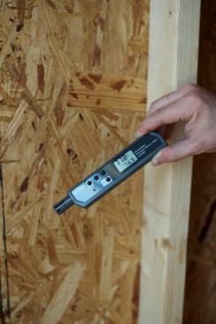

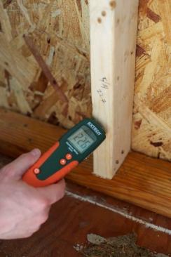

Once you've removed all the absorbent materials, it's time to bring in fans and dehumidifiers.  Carpet dryer fans are best for this because they move a lot of air right along the floor line.  They can dry a soaked carpet pretty quickly if you had a "clean" flood and are salvaging the carpet.  Dehumidifiers are key to drying, as a fan won't do much good if the humidity is high.  Commercial-grade equipment is pricey to buy unless you are a contractor who can use it in the future.  I use a ton of this equipment in my remodel/new construction company, and I like Quest equipment. You can also rent these from a local construction equipment rental house, or you can call a restoration contractor, which will  own these and may rent to their clients.  Remember to check the moisture content of your framing lumber to know if it's dry enough.  Get the framing below 20% and ideally below 17% before moving on with rebuilding efforts.  (Wood is considered saturated at 30% moisture content and mold will grow when wood is consistently above 20% MC. For more on drying wood and how I use Quest equipment, see "Conditioning Homes," Nov/14)
