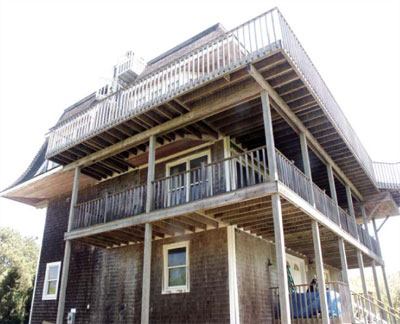

Built in 1994, this house is surrounded by sand dunes on a barrier island, with the ocean to the south and a saltwater bay to the north. To capture a 360-degree view of the water over the high dunes, we built a rooftop deck of mahogany, suspended over a rubber membrane roof. On the side facing the ocean, the building has a two-story elevated deck; part of the top-story deck is framed as a stacked double cantilever that supports a large hot tub.
After 14 years building waterfront homes, architect/builder Andrew DiGiammo took an inspection tour of one of his early homes to see how the materials he had chosen were holding up.
The structure was ambitious, particularly for me at the time as a relatively new builder. And the exterior finish materials face especially rough weather, with salt winds from every direction, lots of sun and rain, and seasonal freeze/thaw cycles. After more than a decade under intense conditions, I was eager to see how the materials I had chosen were performing.
In general, I was satisfied with what I found. Some of the finishes would have benefited from a little routine maintenance, and in a few cases I could have selected more appropriate hardware. But the structure was in excellent shape, and even natural wood that had not been maintained was mostly in good condition. A few items did take quite a beating, however — providing a reminder that the coastal environment is not a gentle one.

This house was one of the first buildings in which I used treated engineered wood (Figure 1). The entire house is built on a framework of preservative-treated Parallam girders ( www.trusjoist.com), supported by concrete piers resting on isolated pad footings. Posts for the second- and third-story decks are also treated Parallam (continuous 6x6s that run the full height). After more than 10 years in the weather, all the Parallam timbers are in prime condition — they look as good as new.

I used cedar wood without any paint or coating for this home's siding and roofing (Figure 3, page 4). The roof is shingled with western red cedar, and the walls are shingled with white cedar (which grows in the Northeast). The rooftop deck's parapet walls are sided with red cedar clapboards.
The white cedar wall shingles, in general, are doing fine. They've weathered to varying shades of gray, but they're still doing their job and will last for a long time.
Red cedar is a more durable species than white cedar, and the shingles on this roof are also bigger and heavier than the ones on the walls. However, the roof shingles have a rougher exposure than the wall shingles — they're in a more horizontal position, where they get direct rain and sun and can accumulate debris. They're now supporting growths of algae, lichens, and moss, particularly in the lower-slope and more shaded areas.

I used a mahogany decking on all the decks, and red cedar for rails and balusters (Figure 4). All that wood is still in good shape, but the mahogany was not my first choice. As I recall, we used it at the time because the owner had gotten a good deal on this lumber and asked us to use it. I prefer to use ipe (sometimes called Brazilian walnut) for natural wood decks. In my market at least, ipe seems to be a more consistent product, and very weather resistant.
Figure 4. Naturally rot-resistant cedar rails (above) and mahogany decking (bottom) have performed well, but the author notes mahogany can be inconsistent, depending on the variety and on the presence of sapwood rather than heartwood boards in the shipment.
Not that some mahogany isn't durable — if it's the right kind of mahogany, and if it's all heartwood rather than sapwood. The problem is that there are hundreds of species and subspecies of mahogany and no real grading system for them, so you don't know for sure what you've got until you break open the bundle. In my experience, the heavy pieces are heartwood, but lighter boards may be sawn from less durable sapwood. On this deck, I noticed that a few pieces of exposed decking here and there were darker than the others, apparently because they were holding water — maybe because they're sapwood, or maybe just because of the grain pattern from sawing. Down the road, some boards in this deck may need to be replaced.
The rooftop deck on this house is designed for ease of repair, however. As I mentioned earlier, the roof under the deck is a rubber membrane. The deck itself is built in sections, with pairs of joists suspended from parapet walls at both ends of the house and in the center. If the rubber roof ever needs maintenance, the strips of decking over the joist ends can be pulled up, and each section of herringbone deck can be lifted out as a piece.
