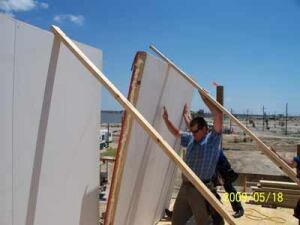

Step one in a four-day, two house build: Standing SIP walls atop stick-framed floor systems on elevated pile foundations. Two-by-four framing embedded into the panels on 16-inch centers serves for attaching metal structural connectors as well as fiber-cement siding.

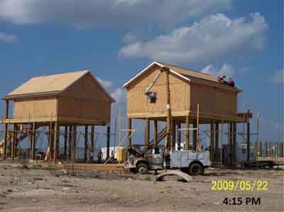

With corner posts and wall beams set, a pre-skinned gable-end timber truss is flown in by crane. A steel rod will tie the truss directly to the foundation.
Eight-inch roof panels with tongue-and-groove wood facing complete the assembly. Insulation levels and air-tightness in these homes will surpass Texas energy code requirements. Will the system take off in Bolivar? Disch is guardedly optimistic, given the difficult situation on the peninsula. "There are people who were uninsured, or are underinsured, or are still fighting with their insurance companies," he notes, "and there are people just waiting to see what the hurricane season has for us this year." But he says there's a buzz growing for his product. "We got a lot of press and TV coverage for that two-house build," he says. "I've got another one being delivered August 10th that is a two-day job." Currently, Disch is looking for a local builder to represent the idea in Texas. "Builders generally aren't the type to go out and promote new things," he observes. "But my rep is going down there on the 10th too, and his purpose is to find a builder that will put up a model home, out there on the Bolivar. Once we have that in place, I think we're going to sell a lot of houses down there. Cause there is no reason to rebuild the Bolivar back the way it was before — there's no way it can stand."
