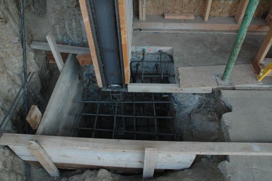

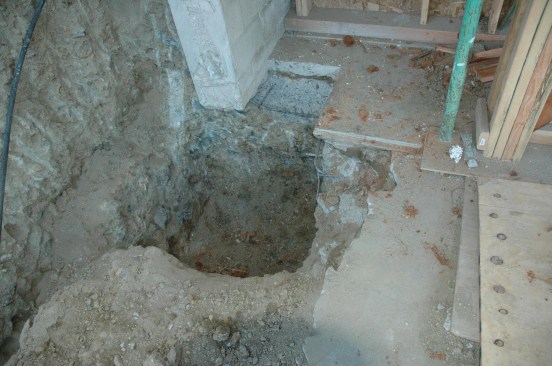

Pad footings. Dig the foundation where the columns’ hold-down anchors will be located. The minimum embed depth, the edge distance from the front and back of the footing, and the distance from the end of the footing to the centerline of the anchor are provided by the moment-frame manufacturer. However, the Engineer of Record may require larger footings. Digging the footing a little deeper not only ensures meeting code for moisture protection, it also makes installation of the moment frame and anchors in retrofit applications easier.

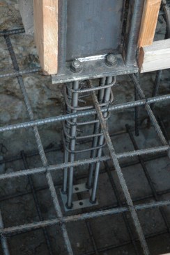

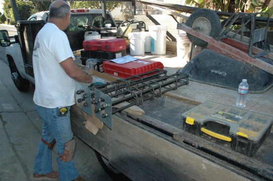

Anchorage. The Template Kit shown includes two Templates, two Bolt Braces, eight anchors with two washers and four nuts per anchor, and rebar shear ties. Anchors should extend 4 1/2 inches beyond the top of the Template. The Template has two slotted holes, one at each end, which are used to measure the inside “steel-to-steel” dimension of the moment frame. When installing the “Bolt Brace” at the embed end, check that the bolt centerlines are oriented in the same direction as the Template.

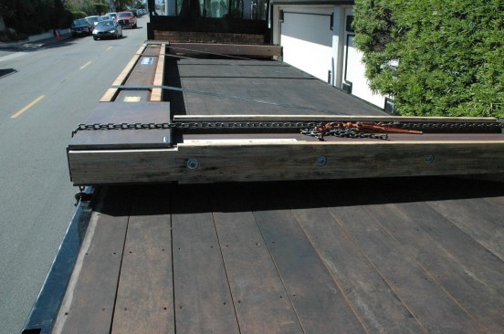

Frame delivery. The Hardy Frame SMF is delivered to the jobsite completely pre-assembled with wood nailers attached. There is no field assembly, no field welding, and therefore no required special inspection for the Hardy Frame assembly.

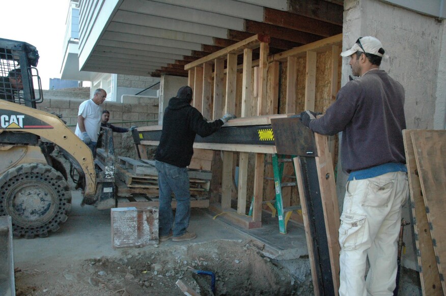

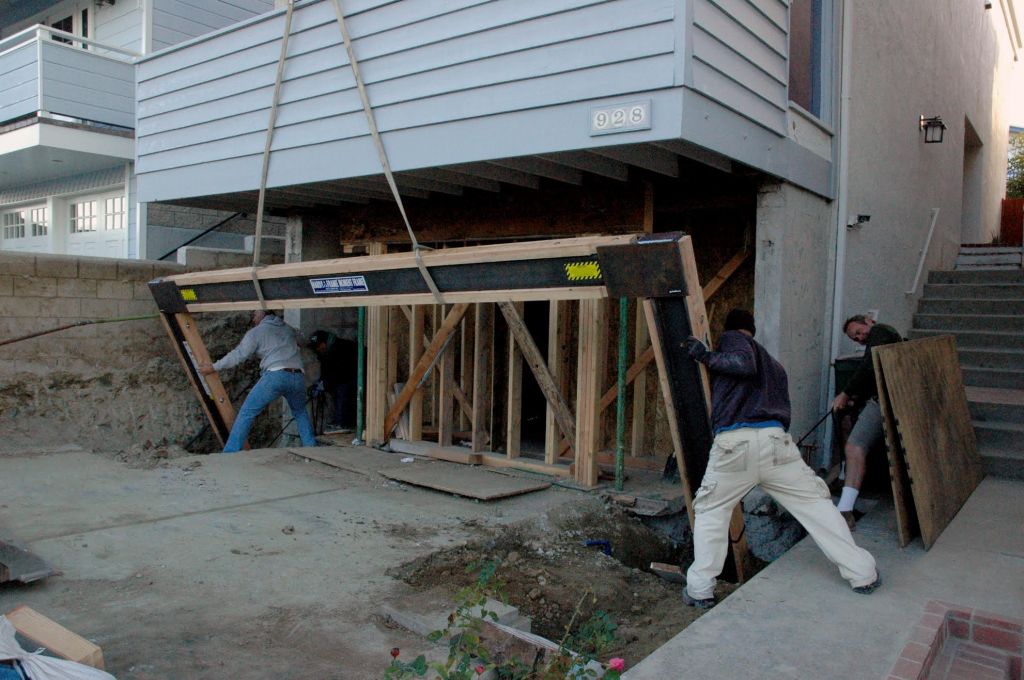

Placement. With the footings prepared and the shoring in place, the site is ready for the installation of the moment frame. Here, the installers have tilted the top of the frame back, away from the building, then moved it toward the point of installation and lowered the column bases into the foundation hole.

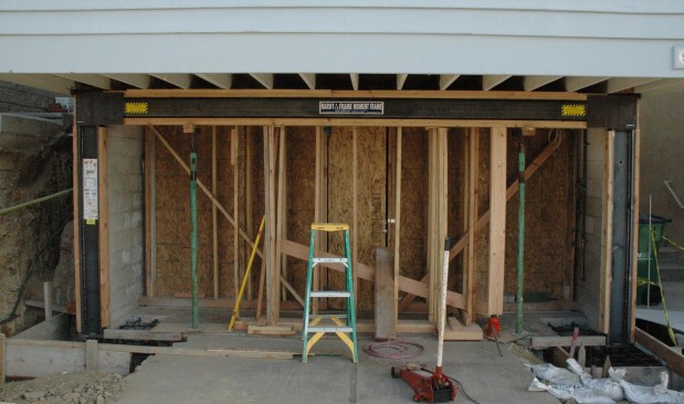

Raising the frame. For retrofit applications with the frame installed within the existing wall line, raise the moment frame until the 3-by nailer on top of the beam is in contact with the building collector. Once the moment-frame assembly is correctly positioned, check that it is plumb and install temporary shoring.
Install anchorage. The anchorage can now be installed at the column base plates and suspended in the open footing. Be sure that the connection has nuts and washers above and below the base plate. The anchors should extend at least one thread beyond the upper nut for easy inspection that all threads in the nut are filled.
Bolt Brace.  A Bolt Brace at the embed end acts as a spreader and ensures the anchors will not sway independently while concrete is being poured, and will keep the anchors parallel and plumb. The rebar reinforcement shown is designed by the Engineer of Record for this project. Be sure to get the anchorage inspected prior to pouring concrete.
Ready for concrete. In this photo, the Hardy Frame SMF is installed and ready for concrete to be poured at the footings. Connectors to transfer shear from the blocking in the floor system to the wood nailer on top of the SMF beam will be framing angles, as specified by the Engineer of Record. The label shown on the left column provides illustrations of typical bottom and top connections for the installers and the building inspector’s reference.
