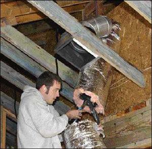

A critical component of an effective cooling system is a well-sealed duct system. Keeping ductwork within the conditioned space (here it runs through a semiconditioned attic) reduces the negative impact of duct leaks.
