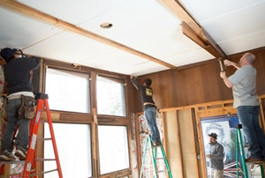

4 – Install the NailersTransfer the measurements from Step 3 to a story pole, then use it to check the layout and make adjustments before installing the softwood nailers. Transfer the marks on the pole to the appropriate locations around the room perimeter, then snap lines on the ceiling. If the existing ceiling has been removed, install blocking where needed to fasten the nailers. Install all the nailers in one direction (in a parallel pattern across the ceiling), then fill in with the perpendicular nailers.

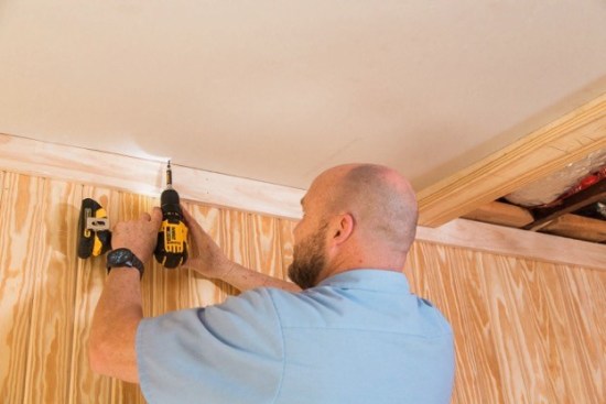

5 – Hang the DrywallInstall additional blocking if necessary to support all edges of the drywall, then measure and cut the drywall to fit each recessed coffer. Use 1/2 in. drywall for 16-inch on-center framing and 5/8 in. drywall for 24 in. framing. (Some codes may also require 5/8 between occupied floors.) Use standard Type W drywall screws that are long enough to penetrate the framing by at least 5/8 inch. (If you left the existing drywall in place you will, of course, need longer screws.) Drive screws every 8 inches along the edges and every 12 inches in the field.

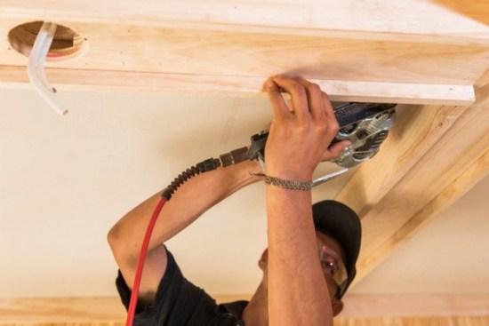

6 – Clad the BeamsFinishing the beams is the easiest part of the job. Start by nailing the pine boards you chose in Step 1 to the bottom of the nailers. Clad the perpendicular nailers first, so that the joints on the finish boards and the nailers don't align. For an interesting 3D look, rip the trim for the sides to a width that creates a 3/4 in. reveal. If the design calls for locating light fixtures on the beam, use a hole saw to cut the necessary holes. The inside edges can be finished with crown molding or not, depending on the beam depth and the customer's wishes.
6 – Clad the Beams

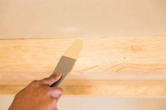

7 – Stain and TrimUse a wood filler to fill in all visible nail holes. If staining, make sure to use a stainable filler. Scrape away excess with a putty knife, sand the beams, and then paint or stain. Mud and paint the drywall and install light fixtures.
7 – Stain and Trim

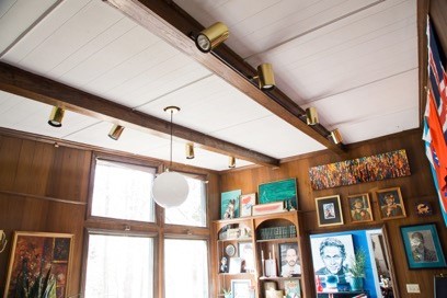

What began as the room's most overlooked surface has now become its most interesting.
