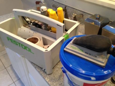

Non-Extractable HSK
When we first started testing the Festool HSK hand sanding kit, (thank you to Festoolusa for supplying the kit for testing) it quickly surpassed the 3m and other blocks that we had used previously – in both function and form. And, HSK is a great recycling program for those "seasoned" abrasives. The only downside with the HSK was the irony of it being a manual tool set, no motors or spinning parts, and also one of the biggest surface dust generators of our sanders – more so than the electric sanders with extraction. All in all, we could live with it, especially when we looked back at the methods that this kit replaced. We like the HSK. In fact, we affectionately refer to it as "the Lunch Box."
But an intermediate option between the slow and dirty manual sanding options and the power sanding/extraction standards we have come to know would be ideal.

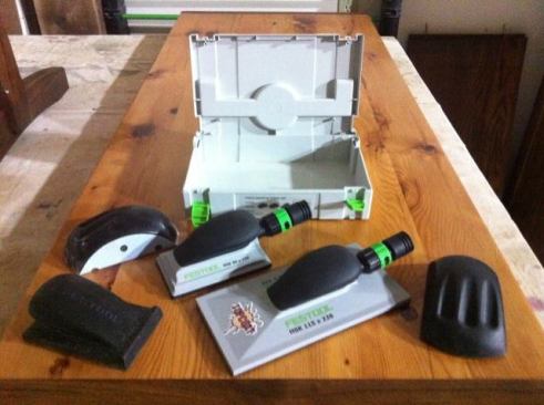

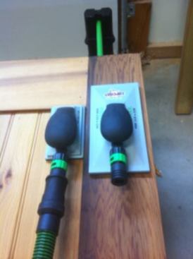

Extractable Hand Sanding Kit (HSK)
In typical form, Festool was forward thinking in the implementation of the extractable HSK. Hand sanding can be done dust free too.
Our Observations on Extractable HSK:
  • Good on wood/small drywall patch sanding
  • Our 2 preferred sizes: 80×130 (3"x5") and 115×226 (4.5x9")
  • Uses existing Festool abrasives (LS130/RTS400/RS2)
  • Adjustable extraction rate
  • Dedicated 22mm hose
  • Great extraction: no dust
Recommended Improvements:
  1. put them on a threaded extension pole
  2. extract through the pole, to the hose, then to the extractor
Meanwhile, we will gladly run the extractable HSK just the way they are.
The Lunch Box is still a popular set on our crew. While Festool power sanders generally eliminate most hand sanding, on those occasions where hand sanding is the best option, it is nice to be able to do it with extraction.
