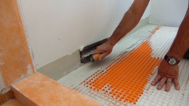

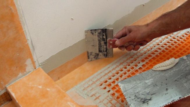

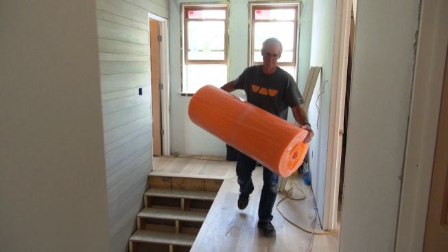

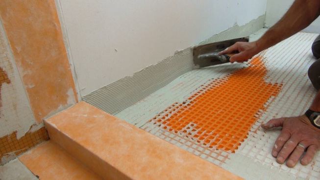

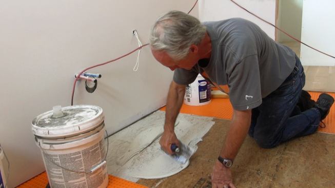

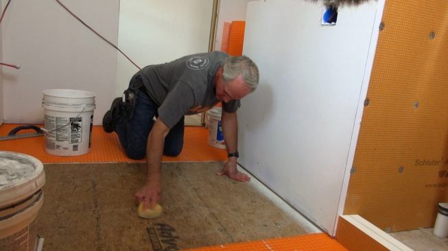

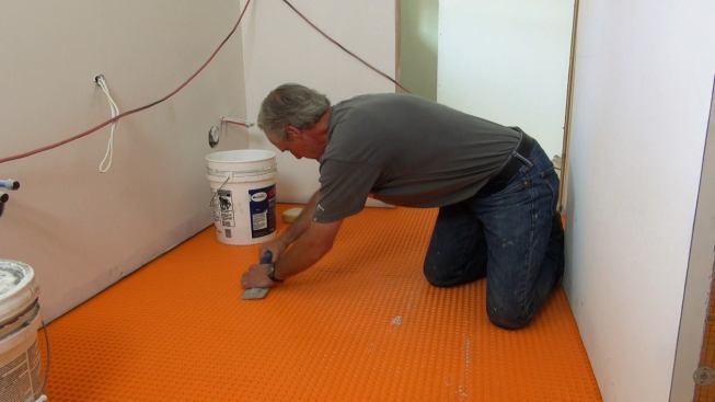

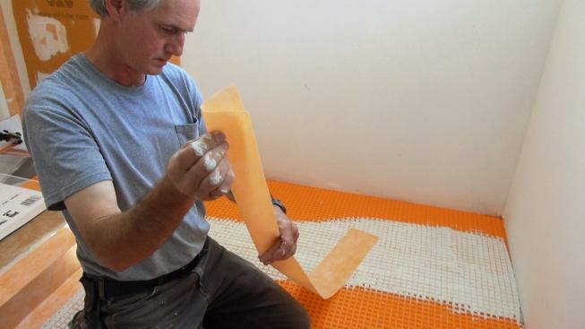

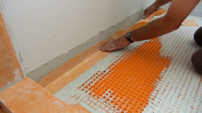

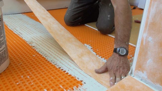

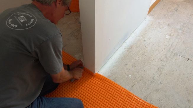

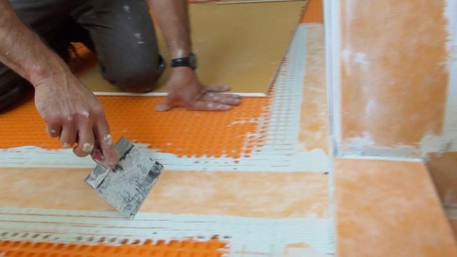

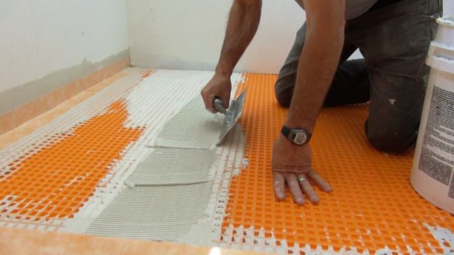

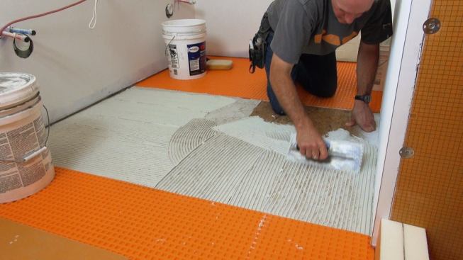

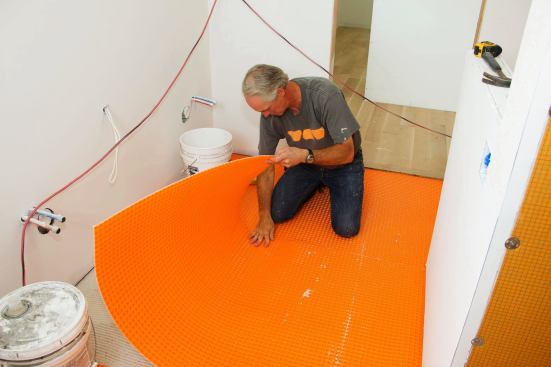

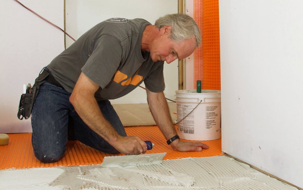

The process is straightforward: Boucher cuts Schluter Ditra underlayment to size and dry-fits it to the floor. Then, he mortars the membrane to the plywood subfloor using latex-modified mortar (“Ditra-Set,” manufactured by Bostik, mixed with Bostik’s 425™ Multi-Purpose Acrylic Latex Admixture instead of water). He seals joints between sheets of the Ditra using unmodified mortar and strips of Schluter Kerdi membrane, and he applies Kerdi at wall corners the same way. When he’s done, Boucher says, “You could fill this bathroom with three inches of water and it wouldn’t leak — except that the water would run out the door.”
Tile contractor Tom Boucher of Integrity Tile, based in Kennebunk, Maine,  applies latex-modified Bostik Ditra-Set mortar to an Advantech subfloor to make a mortar bed for adhering Schluter Ditra decoupling underlayment membrane for a custom marble tile floor in a bathroom for a new house under construction next to the ocean south of Portland, Maine.
Ted Cushman/JLC Tile contractor Tom Boucher of Integrity Tile, based in Kennebunk, Maine, applies latex-modified Bostik Ditra-Set mortar to an Advantech subfloor to make a mortar bed for adhering Schluter Ditra decoupling underlayment membrane for a custom marble tile floor in a bathroom for a new house under construction next to the ocean south of Portland, Maine.
Tile contractor Tom Boucher of Integrity Tile, based in Kennebunk, Maine,  lowers a piece of Schluter Ditra decoupling membrane into a mortar bed to serve as underlayment for a custom marble tile floor in the master bathroom for a new house under construction next to the ocean south of Portland, Maine.
Ted Cushman/JLC Tile contractor Tom Boucher of Integrity Tile, based in Kennebunk, Maine, lowers a piece of Schluter Ditra decoupling membrane into a mortar bed to serve as underlayment for a custom marble tile floor in the master bathroom for a new house under construction next to the ocean south of Portland, Maine.

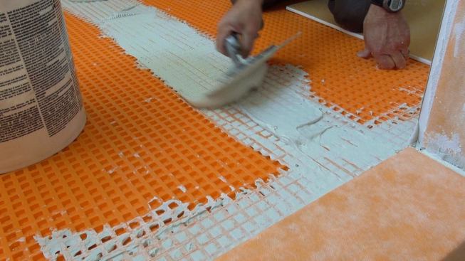

“I buy the mortar and the admixture by the pallet,” says Boucher. “I don’t have to keep a lot of stock, because it’s all the same stuff.” He mixes the powder with the latex admixture when he’s applying Ditra membrane to plywood, and he mixes it with straight water when he’s sealing joints with Kerdi membrane, or setting tile onto Kerdi or Ditra substrates. Used over plywood, the latex admixture helps the mortar bond to the wood, and the wood soaks up moisture and gives the latex-modified mortar a way to dry. But if he were to use latex-modified mortar between two vapor-tight materials — such as between Kerdi membrane and Kerdi-Board, or between tile and Ditra — “it would take forever to dry,” Boucher explains. Unmodified mortar, by contrast, sets up and cures hard even when there’s no way for water to evaporate out of it.
For this step in the job, Boucher is applying Ditra membrane to the Advantech subfloor, mixing the mortar with latex admixture. Schluter’s website describes Ditra this way: “Schluter-DITRA is a polyethylene membrane with a grid structure of square cavities, each cut back in a dovetail configuration, and an anchoring fleece laminated to its underside. Schluter-DITRA is bonded to the substrate using thin-set mortar. The anchoring fleece on the underside of Schluter-DITRA is fully engaged in the mortar to provide a mechanical bond to the substrate. Tile is installed over Schluter-DITRA using the thin-bed method in such a way that the mortar becomes mechanically anchored in the square, cutback cavities of the Schluter-DITRA matting.”
The Ditra performs four key functions in the assembly, Schluter’s literature explains: uncoupling the mortar bed and tile from the wood or concrete subfloor; waterproofing the floor to protect the underlying structure from any spills in the bathroom; vapor management for moisture in the substrate (moisture in the framing or subflooring can diffuse through the voids on the underside of the membrane); and support and load distribution for the tile and mortar floor.
