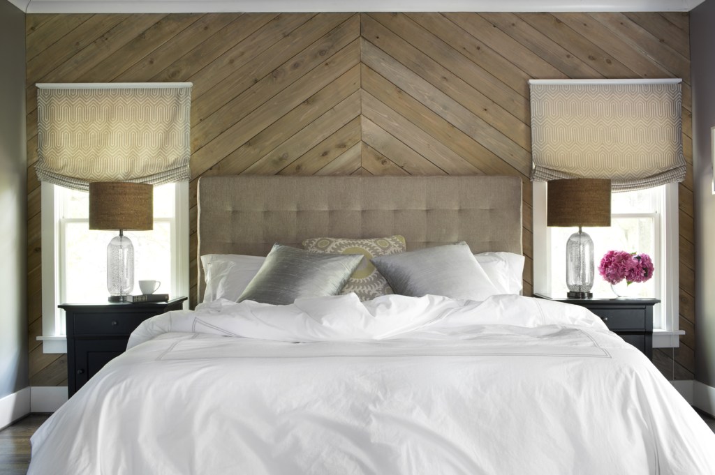

As a design statement, wood walls have a lot going for them. Softwood lumber is affordable and environmentally friendly, and offers a down-to-earth counterpoint to lives dominated by high-tech electronic gadgets. So it should come as no surprise that wood feature walls are a top customer request and interior design trend.
Feature walls are common in Austin, Texas homes, where builder and remodeler Matt Risinger has created many of them. His field-proven tips will help you give clients a wall finish that will look good for years to come.
Choose your wood. Many of the architects Risinger works with spec white or yellow pine with a whitewash paint that lets the grain show through. But any species can be used, including cedar, redwood, fir and pine.
Pick a profile. While 1x6 or 1x8 shiplap is acceptable, tongue-and-groove minimizes the need to face nail. Filled fastener holes aren't noticeable in painted trim, but in a stained or whitewashed wall, they're nearly impossible to hide. You want the homeowners' attention drawn to the wood grain, not to a row of nails. For T&G boards over 1/2 in. drywall, shoot 15-gauge finish nails through the tongue to the framing.
