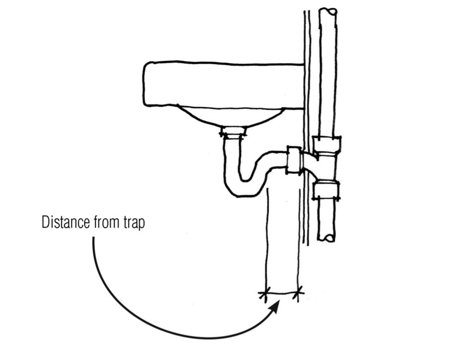

By code, vents must be placed at least two pipe diameters from a fixture trap. In addition, the length of the trap arm is limited to the distances defined in the figure and chart below.
Max. Distance Between Fixture Traps and Vents
Size of Trap (in.) Distance from Trap (ft.)
1 1/4 5
1 1/2 6
2 8
3 12
4 16
