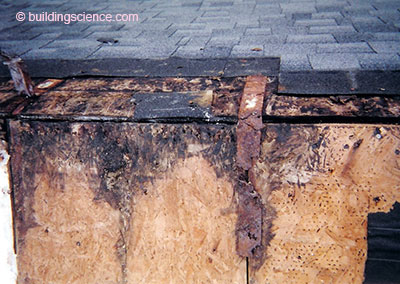

But these, quotable zingers that they are, are off-topic. This week, the real point is a not-so-obvious, obvious building error: Locating leaky ductwork in the attic. For house on slabs, this is common, and the obvious answers that often prove not-so-easy to actually do, are to bring the ductwork into the conditioned space of the house or make the ductwork not so leaky.*
Joe explores in depth the not-so-obvious option of bringing the attic into the house (a version of bringing ductwork into the conditioned space) by building a sealed attic. It works, but it has complications as Joe so adroitly covers:
The name “ridge rot” itself led to what was at the time a crazy way to fix the problem. If we can’t prevent the moisture from getting in, but we know where it all ends up, why not get rid of it when it gets there? Obvious but radical. ... How about a vapor diffusion vent? Not a vent for airflow. No airflow. Just vapor flow in the form of vapor diffusion. Guess what? It worked.
