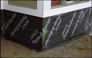

Primary Air-Pressure Retarder
The key to wind-smart detailing begins with a continuous air barrier. In a wood-framed wall without a dedicated air barrier, various solid layers — drywall, sheathing, and cladding — share the job of preventing airflow through the wall. But even with a good air barrier, some of the barrier work will occur in the other layers, because "good" does not mean "perfect." It is the same with vapor retarders: every layer has a perm rating, but the vapor retarder has the highest perm rating.
Rapid variations in air pressure from gusting will try to flex the air barrier. For housewrap or building paper to act as an air barrier, it must be continuously held tight against a stiff sheathing. In northern climates, a poly or paper vapor retarder (which typically acts as the primary air barrier) will belly and tear, so a good substitute is the "airtight drywall approach" (ADA) from Canada. This method relies on gaskets and sealants to stop air at the drywall plane. Rigid insulation outside the studs works in any climate. A self-adhesive membrane applied to the sheathing works well, as does a fluid-applied membrane, assuming it is reinforced at gaps in the substrate and does not form an exterior vapor retarder. One example is Grace's Perm-A-Barrier (Figure 1), which is available in both liquid and membrane formulas ( www.na.graceconstruction.com).
FIGURE 1. The key to wind-smart detailing begins with a continuous air barrier. While ordinary housewrap might work, a self-adhesive membrane applied to continuous sheathing is more durable and less likely to leak once installed. In heating climates especially, it's important to use a specially formulated membrane (or comparable spray-on liquid) that will not create an exterior vapor barrier.
