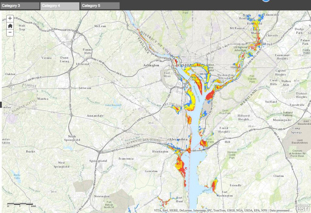

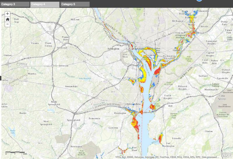

Above, the NHC interactive map displays areas near the nation’s capital that could experience 9-foot or deeper storm surge flooding in a direct hit from a Category 4 hurricane. The new maps are getting press attention in coastal areas. Jacksonville, Florida TV station News4JAX covers the story here (see: “New Surge Maps Show Possible Inundation During Hurricane,” by Blake Mathews), and the Baton Rouge Advocate has a more detailed story here (see: “New storm surge map predicts worst-case scenarios for south La.,” by Amy Wold).

Taken at face value, the map's aggregated "worst case" graphics exaggerate the risk. The bright red area indicating maximum storm risk extends along the entire U.S. coastline, and when a single city is viewed, the flood area seems to cover whole towns and suburbs. But that's a composite view of multiple possible storm tracks, compiled into a single map by a computer algorithm. In reality, only a small portion of the indicated flood zone would really be flooded during any given storm.
"Although alarming at first glance, the map doesn't reflect the effects of a single storm across the coast of Louisiana," the Advocate explains. "Instead, it shows the worst-case scenario for any particular area along the coast, said Barry Keim, state climatologist. 'That map can never happen (in total),' agreed Ken Graham, meteorologist in charge with the National Weather Service in Slidell."

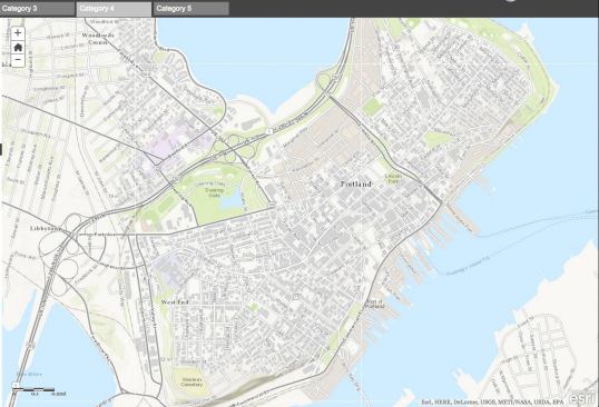

Still, if your street is covered in red, it means that a storm could possibly flood your house — useful information if you're buying or building, or if an actual storm is headed your way. Unfortunately, the NHC map isn't precise enough to evaluate a particular house or building site: the storm surge overlay disappears when the user zooms down to street level. (Parcel-by-parcel flood modeling information is available — for a price — from real estate analytics firm CoreLogic: see "Millions of Homes at Risk from Storm Surge," Coastal Connection 7/22/14.)
"The NHC map is intended as an education and outreach tool to raise awareness on the storm surge hazard for the U.S. Gulf and East coasts," explained NOAA spokesman Dennis Feltgen in an email. "The tool is meant more for a community level view of the hazard, rather than a parcel level view zooming into a specific property. At this time, there are no plans to set the zoom level to go into a closer view. It is very important that the user seeks out evacuation zones or other protective action information from local sources, such as the county emergency management office."
