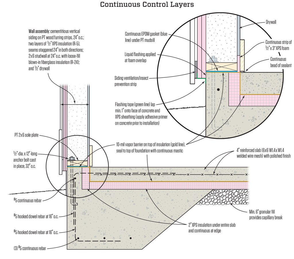

To us, insulation around a house is comparable to a winter coat. You put it on the outside. And in the case of a house, the coat is like a “onesie”—ideally, it should be absolutely continuous. The fewer the interruptions (in the form of gaps, cracks, or holes), the warmer and cozier the home and homeowner are going to be inside that coat, and the longer the home is going to last, by being shielded from the elements.

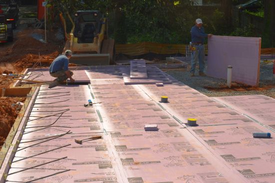

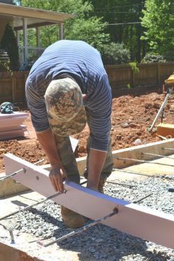

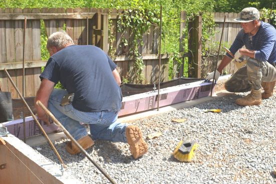

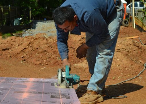

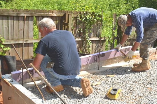

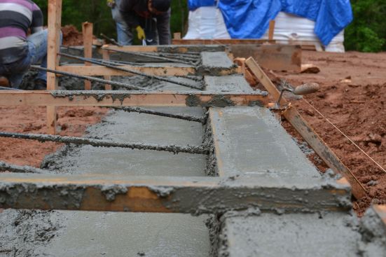

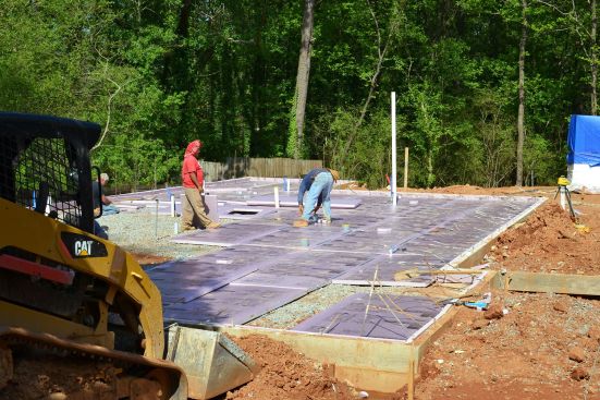

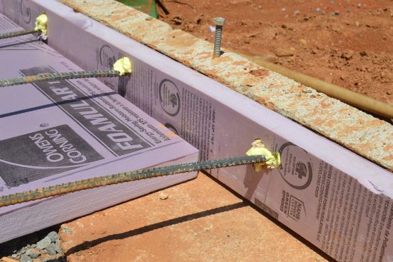

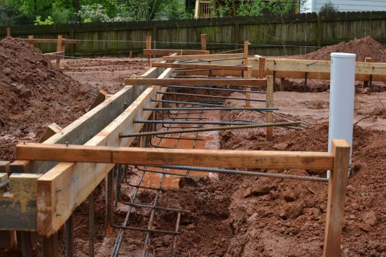

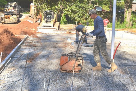

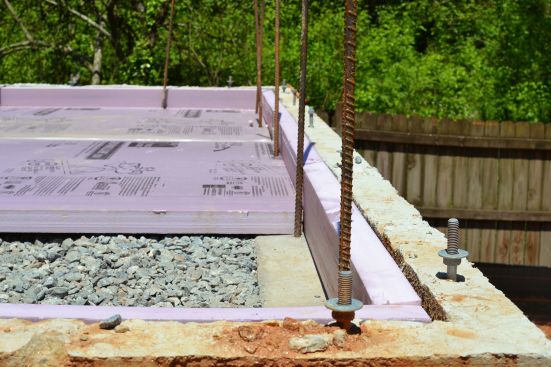

For the “High-Performance Bungalow,” we isolated the reinforced concrete slab from the earth and from the footing with 2 inches of XPS foam. We turned the foam up at the edge of the slab to break the slab thermally from the footing and the outdoors.
In our climate, the ground isn’t cold enough to freeze. Year-round ground temperatures range between 55°F and 65°F. So the heat loss through the slab is never as extreme as it can be through the walls in winter. On the other hand, in a 2,400-square-foot home, the area of contact between the slab and the ground is large, so the total heat loss can add up.
Without the sub-slab insulation, I calculated the heat loss through the slab on the design day in winter at 11,000 Btu/hour.
With the 2 inches of insulation, that number dropped to 3,000 Btu/hour. That’s definitely worth the expense—especially when you consider that the entire heating load of the house on the design day is only 19,250 Btu/hour. (The cooling load is close: 15,000 Btu/hour.)
The foam has its greatest benefit at the slab edge, where conditions are most extreme. In winter, with the home heated to 70°F, the soil under the slab near the center of the floor is at about 55°F to 60°F—a temperature difference of only 10°F or 15°F. At the slab edge, close to the cold outdoor air, the temperature difference can be 44°F to 47°F.
So why bother insulating under the center of the slab? Well for one thing, the polished slab surface is the finished floor in this house. Keeping it even a few degrees warmer underfoot is a significant comfort issue. Also, keeping insulation continuous can be a surprisingly significant factor in limiting total heat loss. But in any case, there was little difference in material cost, while eliminating part of the insulation would have complicated the process, adding labor cost.

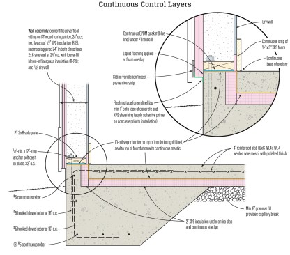

Vapor Control
As I mentioned, one of our design rules is to maintain continuity of the control layers around the entire house, including floors, walls, and roofs. That rule applies not just to the insulation (the thermal control layer), but also to the control layers for vapor, bulk water, and air infiltration.

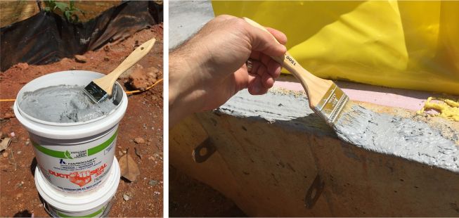

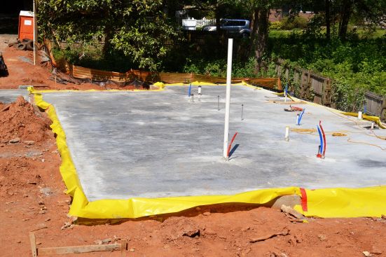

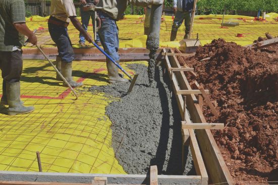

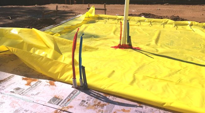

The vapor control layer under the slab is a sheet of 10-mil polyethylene, with seams taped. It’s important to locate this poly above the insulation, directly under the slab. Otherwise, you’re likely to trap moisture between the vapor barrier and the slab, where it can degrade the insulation.
We taped the seams of this vapor barrier carefully and were also careful not to puncture it during construction. But making the sub-slab poly perfectly continuous isn’t highly critical. There’s no air pressure at this location to bring moisture through a pinhole leak, so a few punctures are not a big deal.
On the other hand, the insulation under the slab makes a significant contribution to moisture control. By putting the insulation between the slab and the cool thermal mass of the ground, we essentially keep the slab at the same temperature as the indoor air. That way, we stop the slab from being a cold condensation point for interior moisture in winter, and we also stop it from being a source of inward vapor drive in summer.
The insulation and the poly vapor control layer also contribute to the durability of the slab. By keeping the temperature and moisture content of the slab within a narrow range, we prevent the cycle of expansion and contraction or of condensation and evaporation that can, over many decades, cause deterioration.
The edge insulation around the slab perimeter is particularly important, because it isolates the concrete thermally from the wide swings of exterior temperature. That way, the slab doesn’t experience differences in expansion and contraction that would stress the material.
