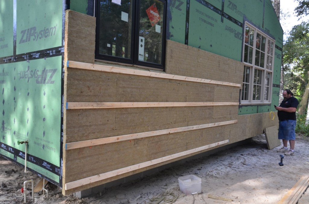

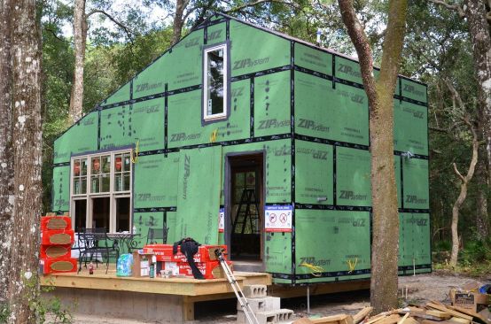

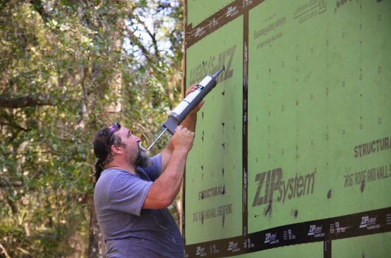

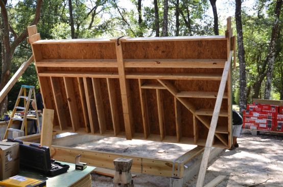

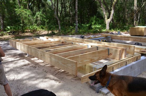

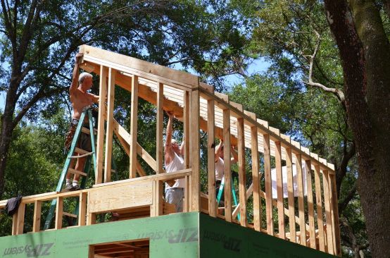

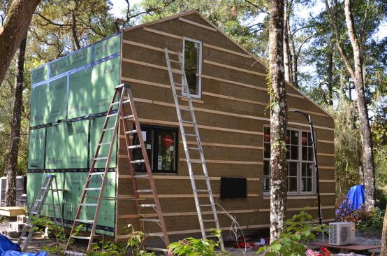

In between larger projects, Chris and Jodi are working on a small cabin in central Florida, designed to test and showcase the latest building science principles — and to demonstrate high-performance methods for the hot, humid climate of Florida, where state-of-the-art techniques and materials are often neglected. The basic concept is to construct an airtight, vapor-open shell with continuous insulation applied outboard of the structure.
The benefits of the insulated jacket, Chris explains, go beyond energy. "One of the primary goals of any of these jobs is to be durable," he says — "making it durable to make it comfortable, and so it will last for a very long time. To do that, we are trying to protect the structure. To have your control layers continuous around that structure, to protect it from the environment, is the goal. So the idea is sort of building a beer cooler, and then your structure is within that cooler. So we have the insulation go completely under the house, up the exterior, and then up and over the roof structure, containing it within it."

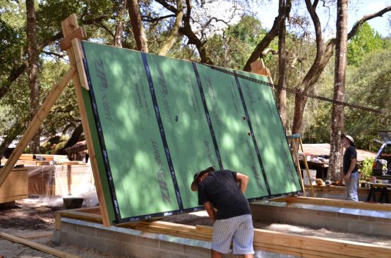

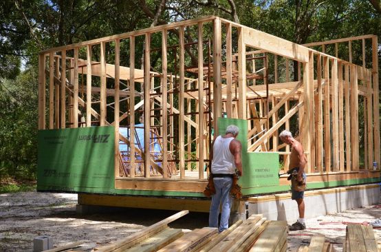

For the small cabin, Chris says, the pair is reaching for the ideal implementation of that idea: "We're taking the wall assembly, turning it 90 degrees, and making it the floor. We're going for a perfect wall and perfect floor assembly, all connected, and super tight." At this point, the cabin is framed, sheathed, and insulated, and a crew is working on the mechanicals. Laumer-Giddens passed JLC a few photos: for a closer look, see the slideshow below.
