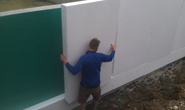

The Surry house's foundation is a full basement with a bulkhead entry, rather than the simple raft slab of last year's house. So instead of using the thick EPS foam as an insulated form system, Corson had to form and insulate in separate steps. It's a full basement, but that comes at a price: says Corson, "Including the concrete and the sub-slab and perimeter insulation, the Knox house has an $8,500 foundation. This is a $20,000 basement. But for the difference, the Surry homeowners are getting 1200 square feet of clear-span useable space."

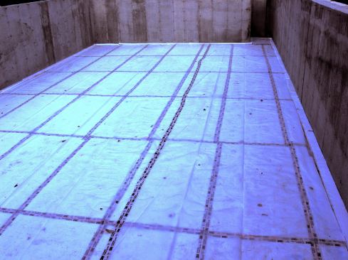

Even though the basement floor is below the frost line, Corson insulated under the slab with the same 8-inch polystyrene insulation. Seams between blocks of insulation were sealed with injectable foam sealant, and then taped with 3M tape. Then, a poly vapor barrier was applied over the insulation — again, taped at all joints and seams.

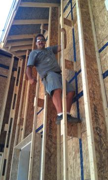

Corson's frame wall system has undergone a few small improvements. Window bucks have been downsized from 1.25 LSL stock to 1.125-inch rim-board material, to cut costs and reduce thermal bridging. And where the I-joist outer wall framing passes by the windows, Corson no longer uses full-length I-joists — instead, he combines short sections of I-joist with ripped 2x stock to create a member similar to Larsen trusses. This eliminates a hard-to-insulate narrow gap that occurred next to the windows in the previous arrangement.
For a project last summer, Corson used the combination I-joist and sawn-lumber combination for all the exterior walls of a house, alternating with full-height I-joists, to save material and reduce thermal bridging (see photo below). But he says he's on the fence about that idea. "It's less material cost, but the labor of making up the pieces adds cost," he says. "And I don't think it's justified by the energy savings." And, he adds, blowing the wall cavities with dense-pack cellulose was difficult when he had created four-foot-wide cavities instead of two-foot spaces. So for the Surry house, he says, it's back to full I-joists — except at the window locations.

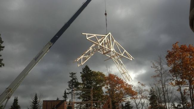

The complex roof on the Surry house added some challenges to the job. Instead of a simple flat attic piled high with cellulose insulation, Corson had to devise a more intricate truss assembly (below). But he was still able to achieve R-80 to R-123 insulation values throughout — enough to satisfy the Passive House design criteria.
