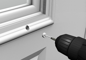

1. Locate and remove all screw plugs and attachment screws from the door. Old paint, putty or caulk may need to be removed from the screw plugs first.

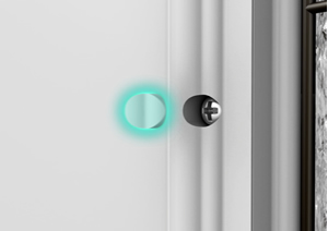

5. Align the screw plugs and tap each into place.
