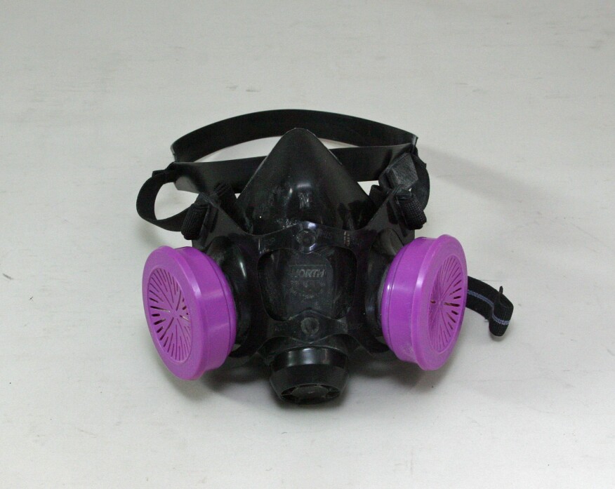

Respirator 101
Absent a foolproof system for working dust-free, everybody who’s on site during the leaded portion of the job must be outfitted with eye protection—either goggles or wraparound safety glasses—and a respirator. Theoretically, a reusable half-face respirator (photo below) provides superior protection compared with a disposable. But these devices are more difficult to breathe through and come in different sizes. So in order to use one properly, every wearer needs to get the following:
  • Medical clearance from a doctor
  • Training on how to use and maintain it
  • Fit-tested
A reusable, half-mask respirator provides reliable protection for workers, but only if it is properly fit, and requires careful fit testing. They are available in a variety of sizes. This one is sized “medium.”
Experts agree that the best respirator in the world will do more harm than good if it doesn’t fit properly. “When I worked in the lead industry in the 1970s, respirators came in one size only and it was ‘Not Mine,’” says Dan Askin. “Several years later, I came upon one of those respirators and I had myself fit-tested and my fit factor was 2” (meaning that the filter was capturing only 2% of the pollutants he was breathing in). Mr. Askin points out that a half-mask respirator can also inhibit one’s ability to talk to co-workers. “If you have trouble communicating, you’re going to be taking it off and putting it back on, giving you no protection for the time that it’s off your face.”
