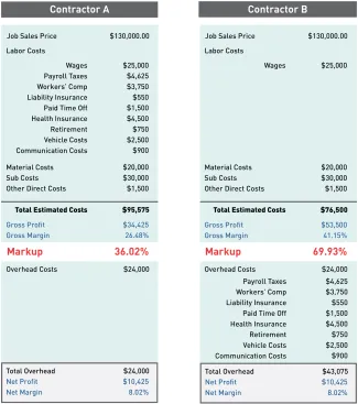

Comparing Apples and Oranges
Markup is irrelevant, because the estimated costs that you “mark up” will vary depending on how you’ve set up your financials. That means that even if you charge the same price as a competitor, your markup can be vastly different. Let’s look at how two different contractors may organize their cost categories (refer to the charts above).
Contractor A has included his labor burdens under Costs of Goods Sold. Therefore, when he estimates what the job will cost, his labor costs will be fully burdened, making the estimated costs high. Because he classifies his production labor burdens in Costs of Goods Sold, his overhead is low.
Contractor B includes only production employee wages in Costs of Goods Sold and includes all burdens in overhead. Therefore, when he estimates what the job will cost, his labor costs are partially burdened, making the estimated costs lower. Because he classifies his production labor burdens as part of overhead, his overhead is higher.
Both contractors charge exactly the same amount for the job, but because of the organization of their costs in their financials, they will apply very different markups to their estimated costs in order to arrive at the same sales figure. In addition, they both are aiming at the same net margin figure (about 8%).
So when uninformed customers compare Contractor A’s markup (36.2%) with Contractor B’s markup (69.92%), they think it’s obvious that Contractor B is charging much more, even though the sales figures are the same. And this is exactly why bandying about markup figures when talking with customers is pointless.
