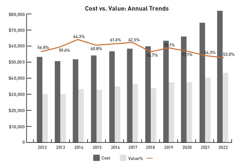

The Cost vs. Value report tracks the ratio of value over cost for 22 common remodeling projects, and in that ratio lies the rub: Across the board, material costs have been increasing for the last decade, and increasing sharply for the past two years. And even while values have also been steadily inching up for the past five years, the high numbers on the bottom of the ratio (cost) bring down the overall number, which is the return on investment.
A look at yearly trends (see “Cost vs. Value: Annual Trends,” opposite page) shows that project costs have risen consistently since 2014, with a sharp increases in costs in the last two year brought on by supply-chain disruptions largely created by the pandemic. Mirroring the increase in costs, the value-over-cost ratio as a percentage declined over the same two year period. (Please note the Cost vs. Value report reflects economic changes that occurred the previous year, so this drop reflects activity in 202 and 2021.) It’s worth noting that despite the sharp cost increases for building materials in 2021, the decline in overall ROI in the 2022 report was a modest 1.3%, confirming the resiliency of robust remodeling markets amid economic concerns and supply-chain challenges.
