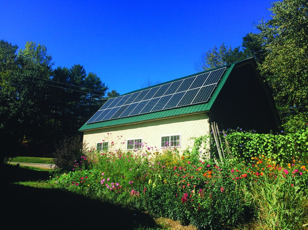

The solar option. A half-hour’s drive away, in the little town of Brooks, Maine, homeowner Hans Albee had a similar experience. When the power from the street failed, Albee’s backup system kicked in without so much as a hiccup. Albee, however, doesn’t have a gas generator. Instead, Albee—a professional engineer who works for ReVision Energy , a major supplier of photovoltaic power systems in Maine and New Hampshire—has a 5.6-kilowatt solar panel array.
A 5.6-kilowatt solar array

“We started out with a basic PV system in 2013,” said Albee, “an ordinary grid-tied inverter with 13 modules, to meet our annual usage at the time. Over the next couple of years, our usage increased, and we wanted to expand the array. At the same time, Pika was interested in doing some beta testing with some of its equipment. We ended up getting some of the first inverters it produced. Then, when it started to bring its batteries to market, it wanted a place to put that battery in a real live situation as well. We were a willing guinea pig.”

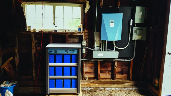

The solar array combined with a Pika Energy battery and controller inside the barn, kept Hans Albee’s house powered up during a recent statewide power failure in Maine.

“So what we have currently,” Albee said, “is a 5.6-kilowatt array (22 modules), and a 7.6-kilowatt inverter, the Pika Energy Island, and the Pika Coral battery. The Coral is a sealed lead-acid absorbent glass mat (AGM) battery. We chose that type of battery because our batteries are in an unconditioned barn, where it’s cold, and the lead-acid batteries handle that better than some other kinds of battery. We also get a little bit higher power out of the lead-acid; the Coral has about 15 kilowatt-hours of total energy storage, and it can produce 8 kilowatts of continuous power and up to 12 kilowatts peak output.”
How long could Albee’s house function in a power failure? “The short answer,” said Albee, “is forever—as long as the sun keeps shining. We can use more energy in summer than we can in winter, just because there’s more sunshine. But we can run as long as the batteries are functionally serviceable. The inverter should last for 20 years, and you can get 30 or 40 years out of the panels. You would never have to connect to the utility again. It’s more convenient to hook to them, but I don’t have to.”
