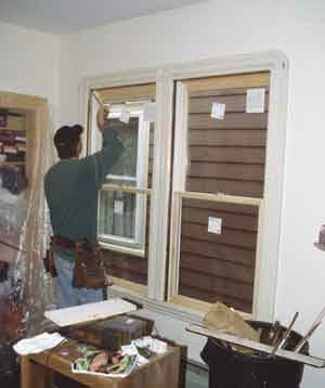

Window Treatment
Windows are a prime source of noise transmission. Most of the homes that we treat are older, with single-glazed sash and retrofitted combination storm/screen windows applied to the exterior. In terms of noise-resistance, these windows amount to little more than a hole in the wall (Figure 2).
Figure 2. Without special glazing, frame, and sash properties, a window isn't much more than a hole in the wall where noise will enter freely. An acoustical window, capped by a high-performance triple-track storm window, can reduce sound transmission by 50% compared to conventional windows. Window remediation commonly requires complete replacement of the old units. Although not the intent of the program, reduced heat-loss through the replacement windows also benefits the homeowner. Ordinary windows, whether single-glazed or insulated, provide little barrier to noise. When field tested, ordinary wood windows without a storm panel yield an average noise reduction (NR) performance of 22 dB. The same type of window with a secondary storm unit applied yields an average NR performance of 25 dB. By contrast, the acoustical window combinations typically used in sound-insulation programs result in an average NR performance of 35 dB. Airtightness. The additional noise reduction achieved by the acoustical window is due to its airtight construction (air infiltration typically less than .10 cfm at 25 mph) and the wide air space (2 inch minimum) between the prime and storm windows. To effectively address the windows as a noise path, we replace all the existing windows with high-performance acoustical units. Vinyl acoustical windows are popular with many homeowners, given their easy maintenance, tilt-in operation, and the range of colors and grille patterns available. The window we use most commonly, from Harvey Industries (see "Sources of Supply", page 3 of article), is a vinyl unit with a sound transmission class rating (STC-rating) of 29. By adding a high-performance triple-track storm window on the exterior, STC-ratings of between 39 and 45 can be achieved. Laminated glass is typically required in order to achieve the higher range of these STC-ratings. Laminated glass consists of two or more layers of glass bonded together by a transparent plastic interlayer. The increased mass of the glass and the dampening effect of the plastic interlayer both contribute to its superior sound-insulation characteristics. Wood windows. Acoustical window treatment options are not limited to vinyl windows; wood and aluminum units are available as well. Wood windows are the preferred acoustical window treatment for homes where the aesthetic of the home requires it, or for homes where there are historic considerations. With wood windows, STC-ratings of up to 40 can be achieved by installing a high-performance wood replacement sash and high-performance storm window or secondary glazing panel separated from the primary unit by a 2-inch airspace. "High performance" is defined here as having an air infiltration rate of less than .25 cfm at 25 mph for a primary window and less than .33 cfm air infiltration at 25 mph for a storm window. Homes that are on historic registers may be compelled to use a secondary glazing panel on the interior of the prime sash rather than an exterior storm. Such interior panels are acoustically equivalent to an exterior storm as long as they are well gasketed, tight fitting, and maintain a 2-inch air space between the secondary and primary windows. Glazing in the wood replacement sash is typically 1/2-inch insulating glass. Aluminum acoustical windows are preferred for most commercial, institutional, and high-rise installations, but they're also available for residential use. They are typically a dual window configuration; that is, two sets of parallel sashes separated by a minimum 2-inch air space in a single master frame. By varying the type and thickness of glazing in the sash and the width of the air space between the two sets, the window can easily be configured to create much higher STC-ratings than those available in vinyl or wood windows. There are a couple of drawbacks to using aluminum acoustical windows. First, the frame depth of the aluminum units used in residential construction is 5 1/2 inches, which can create tricky detailing in a typical wood-frame wall. Also, their sash are typically single-glazed and are "side-loading" — the double-hung sash must be slid sideways within the jamb and physically lifted out to clean it. These two features make them less popular with many homeowners who have come to expect insulated glass and convenient maintenance. However, the windows do come in a variety of colors and offer various grille configurations. Aluminum acoustical windows work well where higher STC-ratings are required, wind loading is a design issue, and wall depth is not a controlling factor. Shutting the Door on NoiseDoors that lead directly from the exterior to the interior without an intervening air space or vestibule are major noise paths. As it happens, solid-core wood doors are highly effective at reducing noise energy by virtue of their mass. We typically install 1 3/4-inch wood raised-panel doors with a panel thickness of no less than 11/8 inches. The maximum area of any glazing in the door can be no more than 50% of the total door area and should be 1/2- or 5/8-inch insulating glass. The expected STC-rating of the prime door is 34. Secondary door. The noise-reduction properties of the prime door are significantly enhanced by adding a high-performance storm door outside. "High performance" for leaf-type storm doors is defined as having an air infiltration rate of less than 1 cfm per square foot at 25 mph. There should be a minimum 2-inch air gap between doors, which may require a special build-out of the existing door's casing. The storm door helps reduce noise by virtue of its mass, with the core consisting of 3/4-inch-thick flakeboard or laminated fiberboard. The door has an aluminum or vinyl skin with various color and applied trim styles. As with the primary door, the maximum size of any glazing should be no more than 50% of the total door area. The expected STC-rating for the storm door is 28.
