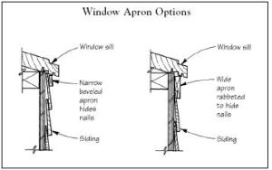

Q. How do you lay out shingle siding so the courses break evenly above and below windows? And what’s the best way to secure the row of shingles below a window so the nails aren’t exposed?

As for concealing the nails, the only way I’ve found to do this is with a piece of trim. Since the trim on the sides and at the top of the window won’t necessarily lay over the siding, but the apron trim will, I usually rip the apron at an angle (if it’s narrow) or notch it (if it’s wide), as shown in Figure 2, previous page.
