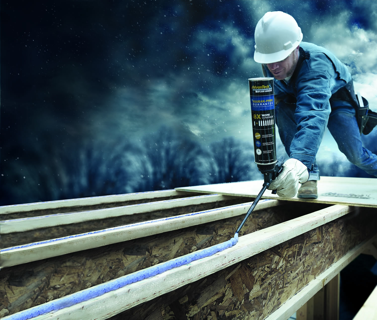

  • Glue the subfloor panels to the joists

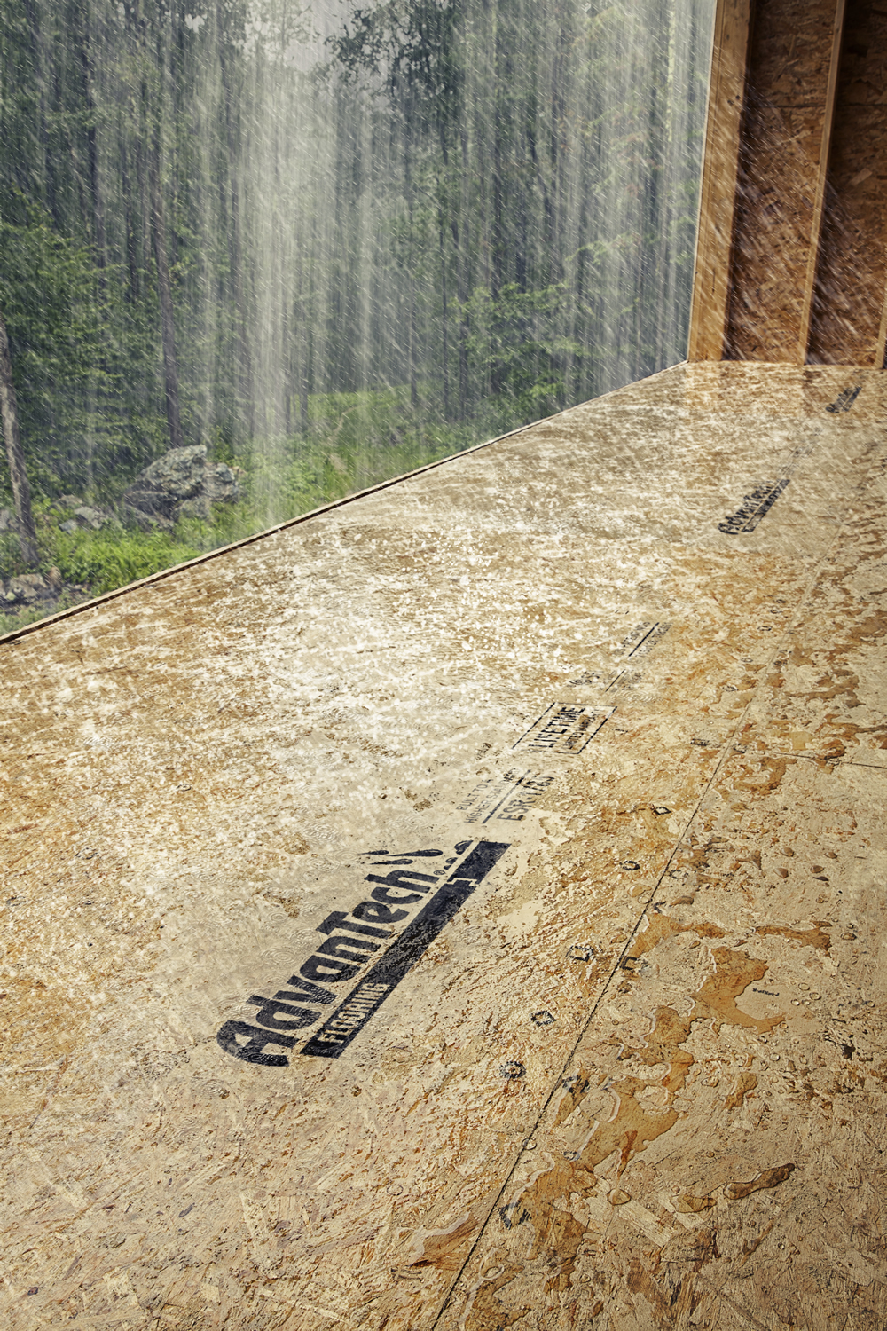

Unlike traditional oriented strand board (OSB), AdvanTech subfloor panels are unique in their combination of high wood density and advanced resin technology. These two factors enhance their performance in many ways. With regard to eliminating squeaks, their greater density provides additional strength and allows the panels to grip hardwood fasteners more securely. Secondly, the next-generation resin recipe and advanced manufacturing processes result is subflooring that resists moisture so that swelling, flaking and sanding are simply a thing of the past. With superior holding performance and moisture resistance, pros can help eliminate the two most common causes of “squeak”: deflection and swelling.
In fact, AdvanTech subflooring is engineered specifically to perform above code standards as documented in ESR-1785 published by International Code Council’s Evaluation Services. AdvanTech subflooring has higher strength, stiffness and fastener-holding values than typical plywood and traditional OSB. This is important, because while subflooring may be an unseen material, subflooring has a huge impact on how high-end floors perform (i.e. feel and sound) over time.
AdvanTech subfloors come with a Lifetime Limited Warranty, a 500-day No Sand Guarantee, and when used with new AdvanTech™ subfloor adhesive, with a Squeak-Free Guarantee for the panel-to-joist connection. For warranty details, visit www.huberwood.com/advantech/residentialwarranty. Learn more about the AdvanTech™ Subfloor Assembly details for a Squeak-Free Guarantee at SqueakFreeGuarantee.com.
