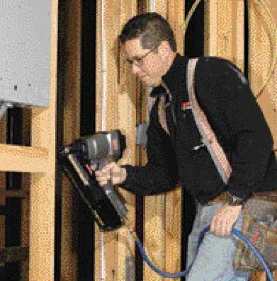

As a framing contractor, I use nail guns just about every day, so it's hard not to notice the way these tools have changed over the years. Today's nailers work better than the ones I've used in the past: They are smaller and lighter and have features that make them easier to use.
For this article, my crew tested 11 stick nailers. We limited ourselves to models that drive 30- to 34-degree paper-collated nails, the fastener we normally use. (Clipped-head nails also come with 28-degree wire or plastic collation, a Bostitch standard that fits guns from a number of other manufacturers.)
We tested tools from DeWalt, Fasco, Hitachi, Makita, Max, Paslode, Porter-Cable, and Senco.
Durability and Power
The tools arrived in the summer of 2004 and we used them into the fall. My crew is hard on tools, so the guns got a good workout. We didn't use them long enough to evaluate long-term durability, but during the time we had them they took all the punishment we could give. In fact, I was surprised by how well-made all these guns seemed to be. The only differences I noticed had to do with small details, like the materials used for rafter hooks and triggers.
