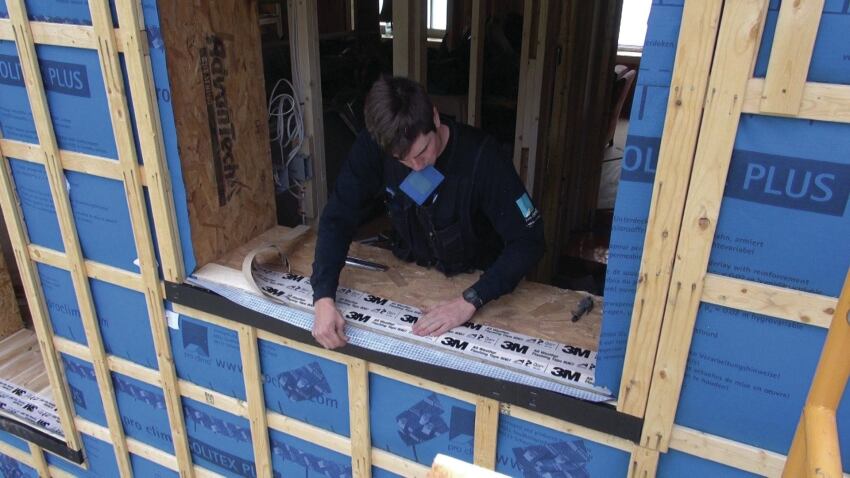

Adding an Insulated Envelope
A sill dam nailed to the front edge of the windowsill is flashed with 3M All Weather Flashing Tape 8067.

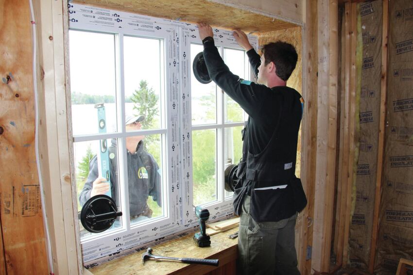

The Intus window is set in place.
The window's edge is sealed to the taped sill dam using Pro Clima Tescon Vana tape to form an inner airtight and watertight seal.
