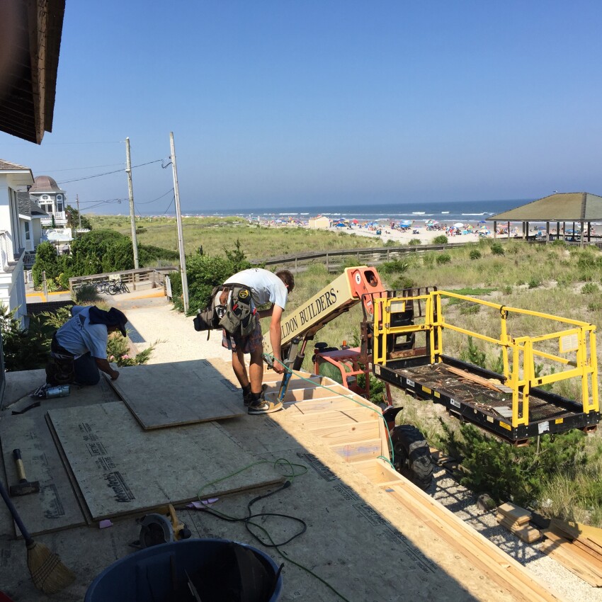

A circular saw rips the joist to the snapped line.
Begin With A Good Frame
Because of the nature of this porch, parts of the floor were framed with dropped beams (with the joists resting on top of the beam) and the center section framed with a flush beam (joists mounted on the side of the beam).
As with a standard waterproof deck, T&G subfloor is glued and nailed to the tops of the joists.
