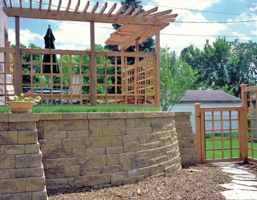

The first segmental retaining wall you build likely won’t look like this, but the photo illustrates the design possibilities offered by these versatile systems, including curved walls and planting areas.
Block Retaining Walls

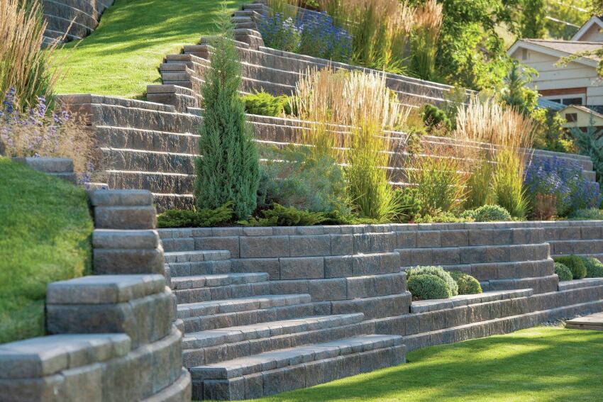

Segmental retaining walls can be used to create planting areas on a steep slope.
