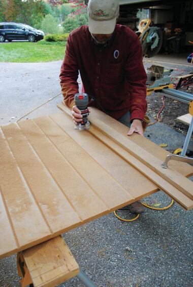

I wanted to dress up the back side of the cabinets, too. My solution was to rout vertical V-grooves into ¾-inch-thick Extira panels, using a straightedge and a trim router. To support the paneling at the outside corners, I added blocking. The crew that framed the deck did a great job keeping the posts plumb, so it didn't take much work to fit each panel between them.
