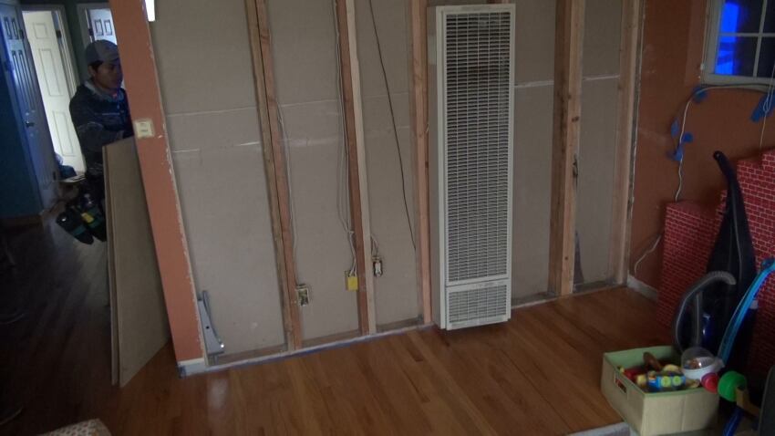

This is one of two shearwalls running across the width of the house. Gregor was able to achieve the strength he needed by doubling up the studs in the existing partition walls, and installing hold-downs connected to the new strip footings installed beneath the walls.
