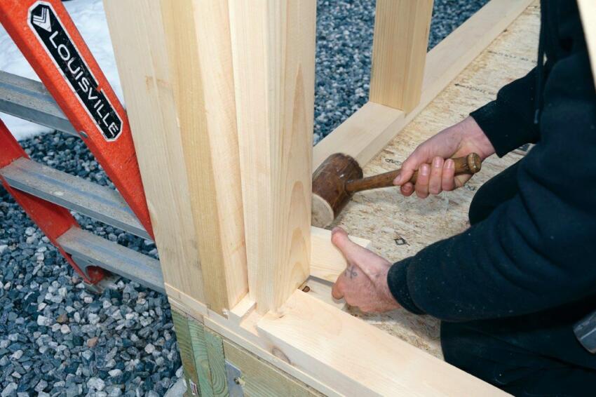

Assembling a Dovetailed Stick Frame
Friel taps a tenoned stud into the mortised wall plate at the base of the wall.
