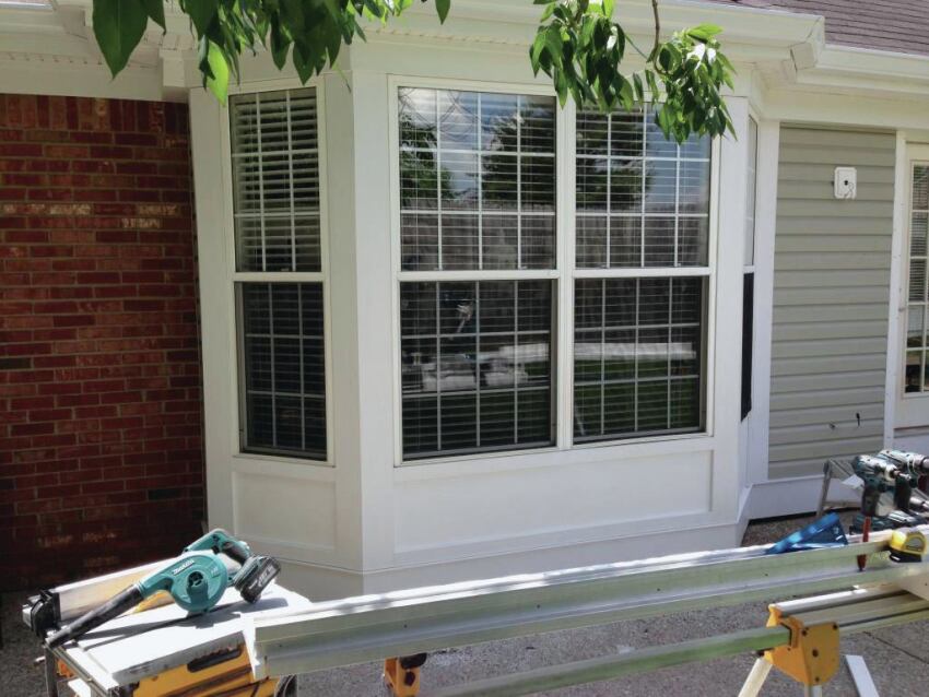

Unfinished PVC
Josh Buesking, owner of Louisville Exteriors, in Crestwood, Ky., says that he often leaves the PVC trim he installs unfinished and has had no complaints.

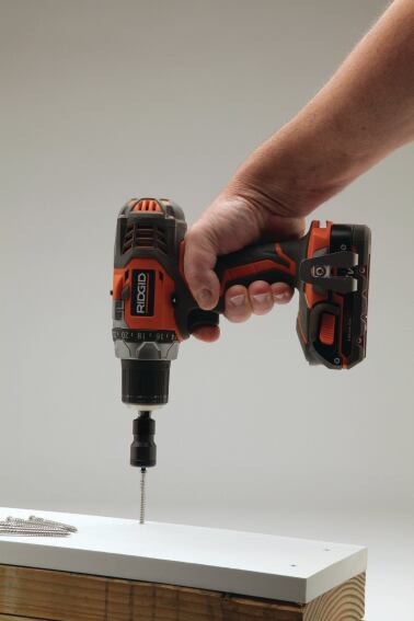

Concealed Fasteners
Concealed fastener systems use self-countersinking screws and special bits that drive the screws to a specific depth.
Plugs for Fastener Holes
The hole in the PVC that was cut by a countersunk screw is concealed with a small cylindrical plug of the trim material that slides into the hole and is tapped flush to the board surface with a hammer.
Screws
Screws, not nails, are an imperative with PVC trim.

Unfinished PVC
This house with unfinished PVC trim was built more than 10 years ago.
Unfinished PVC
This unfinished PVC trim was installed more than 10 years ago and still looks great, except for some discoloration around the cut edges.
