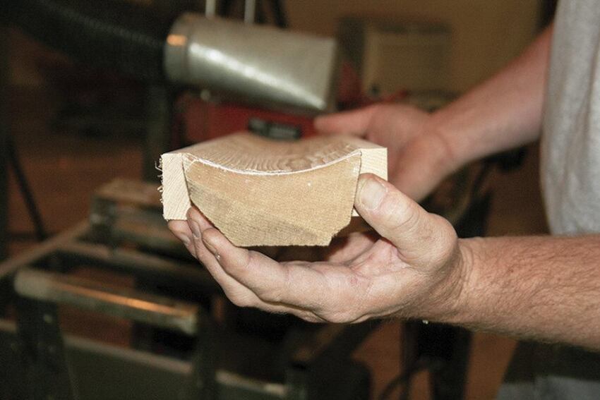

Spanish cedar boards were milled into fluted staves using a William and Hussey VF06 molder. The custom-ordered knives, also from William and Hussey, cost around $150. It took one man one day to mill all the stock.
Greek Revival Column Repair
Sending each piece through the molder twice helped to avoid chattering while hogging out the 1/2-inch-deep cut for the fluted profile.
