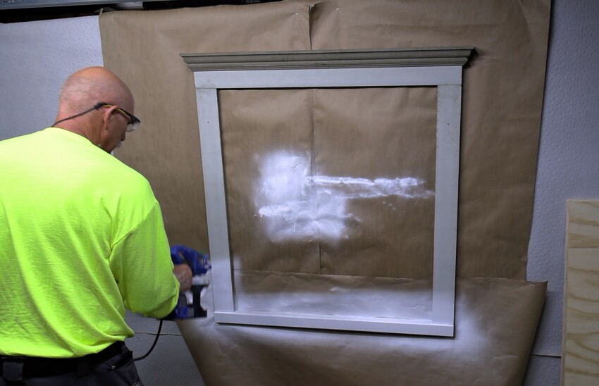

The author prefinishes his preassembled trim units.
