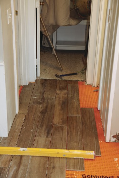

Installation of tile over this uncoupling membrane required two passes of dry-set mortar—thinset that needs to be used over the membrane. The first pass with the flat edge of the trowel forced thinset into the cavities of the membrane.
Layout and Installation
The second pass with a 3/8-inch-by-3/8-inch square-notched trowel combed the thinset perpendicular to the long edge of the tile.
The author applied a skim coat of thinset to each tile.
Before pressing them into place
As the author pressed each tile into place, he pushed it side to side about 1/2 inch.
The perpendicular direction of the trowel lines allows air to escape along the long side of the tile as it beds into the thinset. Every few courses, it’s a good idea to lift up a tile and check the coverage of the thinset. For large-format tile, the coverage should be at least 85% for interior applications and 90% for exterior ones.

After completing each section, the author tapped down the ends of the tiles to minimize lippage. A short length of 2x6 with a scrap of flexible shower-pan membrane glued to it served as a beating block.
He tapped the ends of all the tiles with the block and a rubber mallet until their edges were even.
