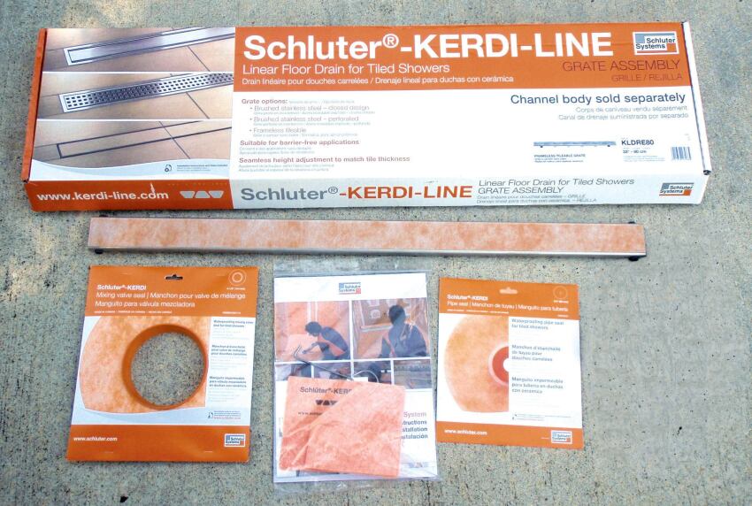

Manufactured by Schluter, the Kerdi-Line system’s drain body (called the channel body) is sold separately from the grate assembly. Drains are available in lengths from 20 inches to 72 inches with either center or off-center drain outlets that connect to the waste line by a hubless connector.
