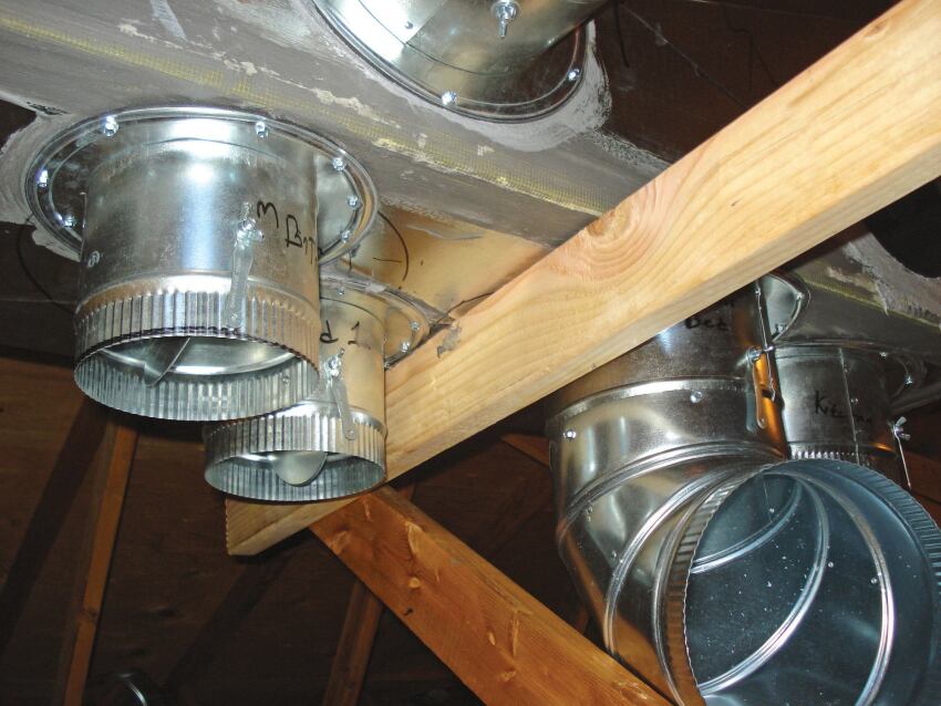

Our crew knows that when metal parts show up on the jobsite, for example, they are wiped down with denatured alcohol in preparation for receiving future sealant. And when supply boots are cut in, they're caulk-sealed and foamed in place before the crew moves on to the next one.
Slideshow: Making the Case for Zero-Leak Ducts
All adjustable elbows that are installed anywhere there is a planned deviation from a straight run of flexible ductwork are taped, secured, and coated "nickel-thick" with mastic and left ready for flexible duct installation after curing.
And all plenum attachments and joints are made with lots of screws and collared takeoffs, using jugs of mastic and reinforcing mesh as needed.
