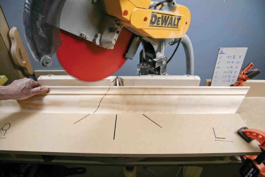

To use the “creep method” for cutting crown, first make a shallow cut close to the line.
Measuring, Cutting, and Coping
Then — with the material firmly pressed between your thumb and the fence — slide it into position for the final cut.

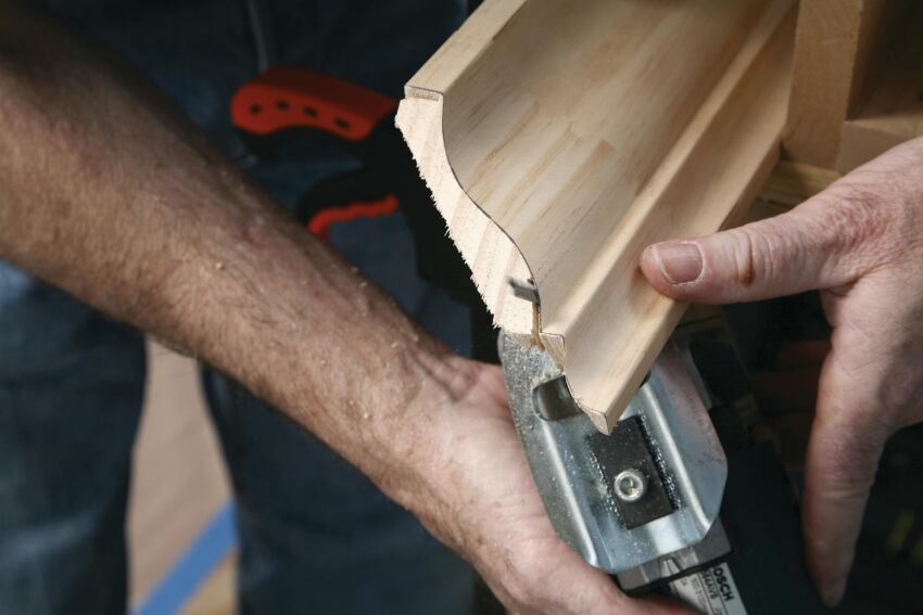

For accurate coping, the author secures the crown with a jig so that he can look directly down the cut line while keeping the saw blade tilted a little past plumb.
After highlighting the edge,
he makes relief cuts at the fillets,
then back-cuts using a Collins Coping Foot.

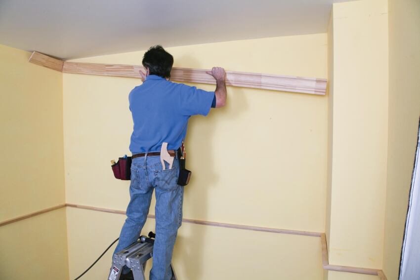

The author works around the room from left to right, with copes on the left ends and butt cuts on the right. The process starts with a temporary starter piece carefully positioned and tacked into place in the corner of the last wall.
The coped end of the first piece of crown is snugged against the starter piece.
The author fastens only the right half of that piece so that it can be flexed away from the wall when the last piece slips in.
Outside corners are gently tacked so the miter can be adjusted if needed.
The author glues and spring-clamps the joint to ensure it never opens up.
