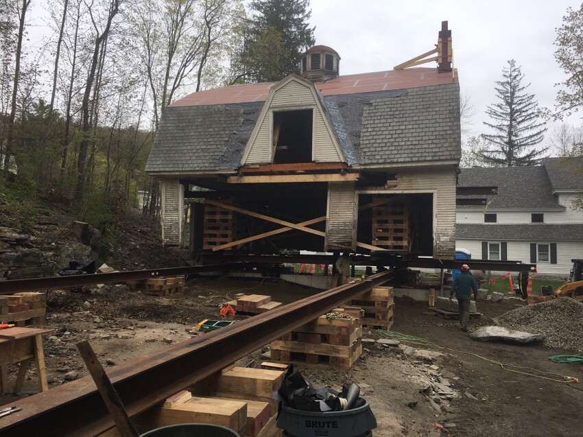

With the I-beam track set and leveled, the building was pulled with come-alongs anchored to the concrete waste-blocks.
Moving & Lowering
Four 10-ton-rated Hilman rollers, two per track, were used to roll the building in place.
Moving & Lowering
A turntable on top of the roller allowed for tweaking the roller’s direction to keep it aligned on track.
Moving & Lowering
It took an hour and a half to move the 30,000-pound structure.

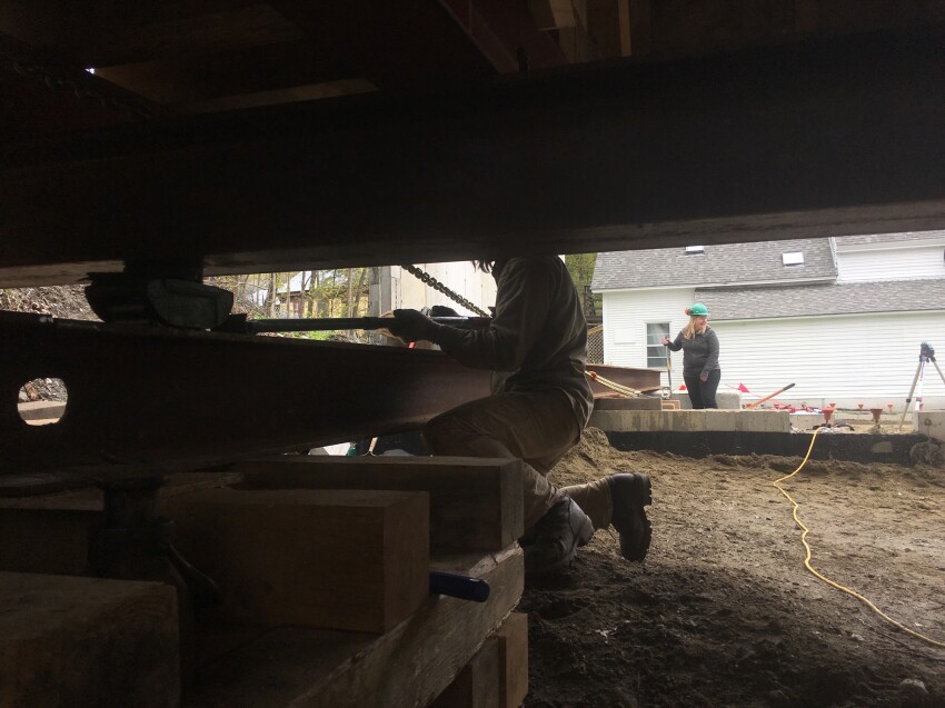

The building was lowered onto new 6x7 sills set on the granite.
Moving & Lowering
The cribbing towers were lowered one tier at time, the steel rolled out with beam rollers.
Moving & Lowering
Hydraulic jacks were used for all the lifting.
