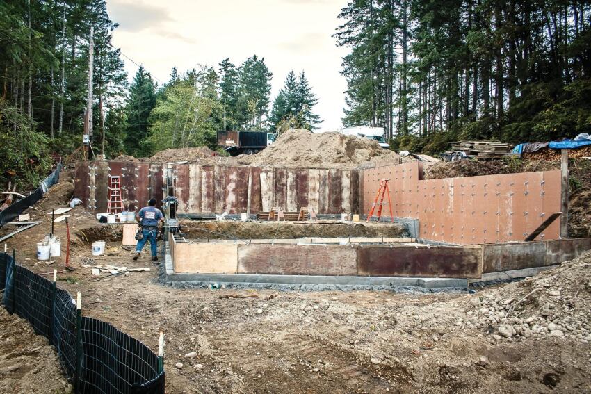

Workers finished up the steelwork before scattering the heavy Plyform panels, with one continuous row of horizontal rebar about 3 inches up and another row at the top of the verticals.

To build 4-foot or 6-foot-tall foundation walls, the author stacks his forms horizontally on snap ties laid across each lower course. Aligning the stacked panel joints vertically speeds installation and makes it easier to strip the forms later.

The author forms 8-foot-tall walls vertically, placing snap ties in slots located 1, 2, 4, 6, and 7 feet along the panel edges.
