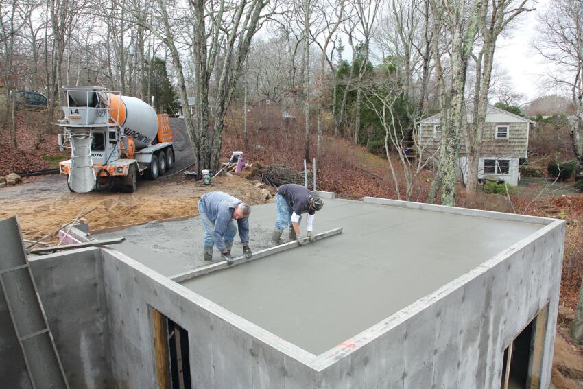

With steel reinforcing mesh on top of the pans and temporary support walls below, we were ready to place the slab.
Pouring a Structural Slab-Part 2
Temporary support was provided beneath the pans in preparation for pouring the concrete garage floor.

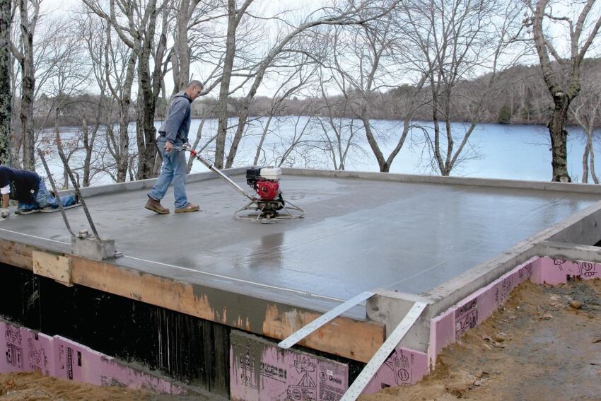

Chalk lines guide the screeding, leaving the slab slightly sloped for drainage.
A power trowel adds the final finish.
