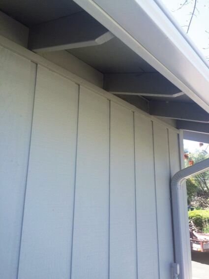

On the part of the house with two stories, the bottom sheets were installed first, topped with metal Z-flashing. The top sheets rested on the flashing.
Repairing and Replacing Sheet Siding
Because rafters and eaves blocking never line up perfectly, the author purposely leaves a 1/4-inch gap at the top of the panels, which he caulks and finishes with 1x3 trim.
