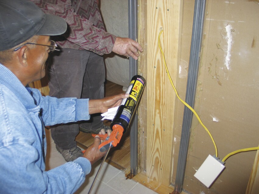

The header track for the pocket door is supported by split studs—thin strips of wood lined with metal. After making sure that the header track fit over the nails, I laid out the positions of the two split studs, marking their positions on the header track and on the floor.
Retrofitting a Pocket Door
After slipping the floor-plate brackets onto the bottoms of the split studs, I held the assembly in place while my helper ran a bead of construction adhesive on the drywall behind each stud position.
To install the other halves of the two split studs that faced the bathroom side of the pocket, we slipped the studs into the floor brackets, positioned them against the header, and drove two screws through each stud to anchor them in place.
